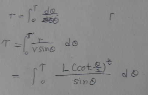

I finish part b now! :)
But I don't know how to integrate the monster in part c.
  • Handwritten derivation: T = integral from 0 to T of dθ/(dθ/dt) gives T = integral from 0 to T of r/(v sin θ) dθ, then = integral from 0 to T of L(cot(θ/2))^(k/v)/sin θ dθ.
Isn't it supposed to be sin2 θ on the bottom?
I'd try the substitution u = cot(θ/2) first.
