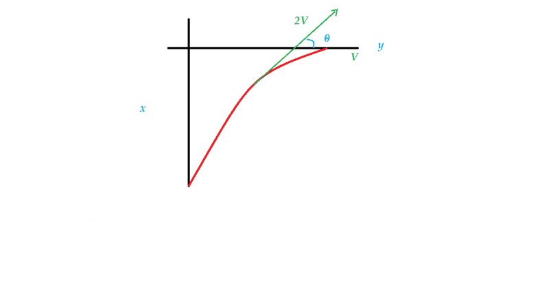

A dog sees a rabbit running in a straight line across an open field and gives chase. In a rectangular coordinate system (L,0), assume:
(i) The rabbit is at the origin and the dog is at the point at the instant the dog first sees the rabbit.
(ii) The rabbit runs up the y-axis and the dog always runs straight for the rabbit.
(iii) The dog runs at twice the speed of the rabbit.
Assuming L=300 units, how much does the dog have to travel to catch the rabbit?
Enter your answer as the distance the dog has traveled from sight to meal.
From the figure
in vertical direction
##-dx=(2v-vcos\theta )dt##
##\int _{ 300 }^{ 0 }{ -dx } =\int _{ 0 }^{ t }{ (2v-vcos\theta )dt } ##
##300=2vt-v\int _{ 0 }^{ t }{ (cos\theta )dt } ##......(1)
in horizontal direction
##vt=2v\int _{ 0 }^{ t }{ (cos\theta )dt } ##
##\int _{ 0 }^{ t }{ (cos\theta )dt } =\frac { t }{ 2 } ##
putting this value in eq (1)
##300=2vt-\frac { vt }{ 2 } ##
##t=\frac { 200 }{ v } ##
I think we have to find displacement of dog.
Distance traveled by rabbit in this time is 200
By pytha
Displacement should be ##\sqrt { 40000+90000 } =360.55##
But this is incorrect.
Where did I go wrong.

How have you defined your dx? Just looking at your figure, the change in x should depend on ##\sin\theta## rather than ##\cos\theta##.
##dx/dt## is the rate at which separation between dog and rabbit decreases.
Does this separation not decrease with ##2v-vcos\theta## ?
This is true. I was confused by your use of x as the variable when you also had an x-axis and I do not see something else strange in that approach at first glance.
However, in the last step, you seem to be trying to apply Pythagoras' theorem, but the path traveled by the dog does not constitute the hypothenuse of a right triangle. Instead, ask yourself this question: If the rabbit has traveled a distance of 200, how far has the dog travelled?
It does. And initially it is 300. But the integral along the path of the dog is not 300. Only the vertical component is 300. In other words: initially dx is what you say it is, but as soon as theta is non-zero, the vertical component changes at a different rate!

As dog velocity is twice the velocity of rabbit so it should cover ##2(200)##.

What he has done is to integrate the total gain of the dog on the rabbit, i.e., he is integrating to find the total distance gained, not the total distance traveled (x the distance to the rabbit, not the x coordinate). He is also computing the total horizontal distance traveled which then gives him the integral he was missing for the gain.
Satvik Pandey said:
As dog velocity is twice the velocity of rabbit so it should cover 2(200).
So is 2x200 = 400 more in line with the expected answer?

Savik has done a very good job up to the point t = 200/v.

I thought that the displacement of dog is being asked that's why I used Pythagoras theorem.I should have read the question more carefully. :rolleyes:
Anyway, your method was ingenious, Satvik!
