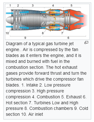

I was watching a video about jet engines, and it was obvious for me and for the instructor that if we compress air at high speed from the gas turbine inlet, then after multiple stages collide with the turbines blades inside, the body will move in the sense of difference in velocity, so forward. At a moment it was obvious, but I can't really explain it why? Can you help me with that using some formulas.
It sounds like you are leaving the combustion part out of your description...?

But the combustion itself can't necessarily provide a motion
Could you explain these parts a little better, please?
Maybe not necessarily, but in a jet engine it sure as heck does! :smile:
Cutaway diagram of a typical gas turbine jet engine with numbered sections from 1 Intake to 10 Air inlet, showing blue airflow arrows through compressor, combustion and exhaust.
https://en.wikipedia.org/wiki/Components_of_jet_engines

The combustion heats the gas causing the volume to increase.
Choosing an arbitrary number, suppose we have
one cubic meter per second coming in and 100 m³/s going out. What does that tell you about the velocities?
