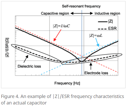

Figure 4 in this Murata document: https://article.murata.com/en-us/article/impedance-esr-frequency-characteristics-in-capacitors
shows that dielectric loss is responsible for a substantial part of the loss at frequencies below the self resonant frequency:
