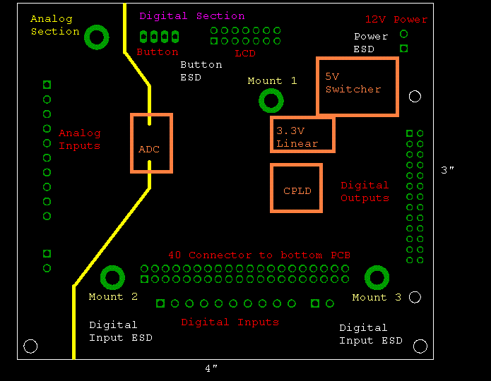

The project involves a control enclosure and a power supply enclosure (both plastic) located about 1ft apart. The power supply enclosure contains an open frame AC to DC power supply with a floating output and the control enclosure contains 2 PCBs on a PC/104 style stack. The top PCB contains a 5V switching regulator, IOs, and a separate analog section which has an ADC used to read 2 load cells (the strain gauges I mentioned in a previous post). The bottom board has a microprocessor, Ethernet, and an SD card.
Based on what we have discussed I need to connect the logic ground of the 2 PCBs to Earth ground. The chassis is basically the aluminum plate in the bottom of the control enclosure that everything is mounted on. The best way that I can think of to make all of the required connections (logic ground to chassis ground to Earth ground) would be to use the PCB mounting holes to connect to the chassis and then run an Earth ground wire from the power supply enclosure to the control enclosure and connect it to the chassis. Since all of the mounting holes are connected to logic ground I can either connect all of them to the chassis or connect only one of them (use nylon standoffs for the others) to facilitate a star ground scheme. I'm somewhat undecided on the best way to go with the standoffs (connect all or only one to chassis?) after examining how it is done in a desktop PC. Using my DMM I found that in a desktop PC the chassis, logic ground, and Earth ground are all connected in the power supply. The motherboard's mounting holes are all connected to logic ground which are then connected to chassis ground by the mounting screws.
What do you think of grounding scheme I've described above?
What would you recommend I do with the standoffs (another potentially important thing to note is that connecting 1 standoff still means making the connection for both boards since they are stacked)?
It would help if you could post a picture or sketch of the setup. Also, what DC voltage goes from the power supply to the PC/104 assembly? What ESD protection circuitry is on the PC/104 PCBs for any wire entries or other user-accessible (hit-able) buttons, etc.?
My initial recommendation would be to use just the single conductive standoff stack for the tie, and make that at the PCB hole closest to where the power supply cable enters the stack. If there are IO cables all around the periphery of the PCBs, though, then I'd vote to tie to chassis at all of the PCB holes, to better allow ESD clamp currents to get out to chassis without going through sensitive circuitry on the way out.
Sorry for the lack of details.
The power supply has a 12V output. What follows is a list of connections that enter the top PCB on the stack and the ESD protection (if any) for each:
- 12V power supply input has a unidirectional TVS diode (PN: 1SMB12AT3G)
- 9 digital inputs used for inductive proximity sensors and photoelectric sensor have 10K series resistor followed by a diode clamp (PN: NUP4301MR6T1G)
- 1 digital input for user-accessible button has a 10K series resistor followed by a diode clamp (PN: NUP4301MR6T1G)
- Analog inputs for 2 load cells have 5.49K series resistors. These inputs are connected to 2 LT1167 instrumentation amplifiers and according to datasheet the series resistors bring protection to IEC 1000-4-2 level 4 spec.
- 10 Digital outputs which use ULN2003A Darlington Transistor Arrays to sink up to 400mA
- 14 pin header for character LCD which is sealed inside of enclosure and viewed through transparent enclosure lid
There are 4 mounting holes total but the only ones connected to logic ground are the ones labeled in the image.
The only connection entering the bottom PCB is Ethernet and no special ESD protection in addition to the transformer is provided.
The top PCB has a CPLD used to handle the digital inputs and outputs which is powered by a 3.3V linear regulator.
See the attached image to get an idea of what the layout of the top PCB looks like and where the ESD protection exists in relation to the mounting holes.
  • Board layout diagram of a PCB with labeled sections: analog inputs, digital inputs and outputs, a 5V switcher, 3.3V linear regulator, CPLD, ADC, LCD header, button, mounting holes and ESD protection areas.
First cut -- I'd use conductive standoffs through holes 1-3, and use non-conducting standoffs for the Analog section's mechanical support (its one hole).
Thanks for looking at the details of the design. I plan on not having the mounting hole in the Analog section connected to logic ground so I'll just use conductive standoffs for all of the holes.
