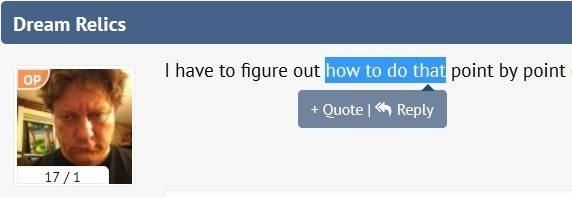

Dream Relics said:
I have to figure out how to do that point by point excerpt quotations that I see other people doing in replies. How does that work?
There are two ways. Selecting the Reply link on the bottom right corner of a post will populate your post with a section like the one here.
If you left-click and select a section of a post, you will get an option like this:
Selecting that Reply option will quote just that section like this:
Dream Relics said:
how to do that
Ah, that method seems to work. Thanks.
