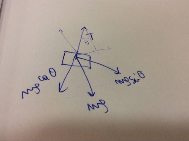

mgCosθSinθ?
Sorry for my poor handwriting.
But I think according to the FBD i have sketched, Tcosθ=mg. and not T=mgCosθ

No, you were right the first time, and you are correct on the horizontal component of the tension. So what is the acceleration of the block?

Neither. T=mgCosθ would be correct if the cart were fixed, but the cart's acceleration reduces the tension.
Let the cart's acceleration be a to the left, while suspended mass has accelerations b to the right (in the lab frame) and c down.
What equations can you write relating these to the tension?
What equation in these expresses the fact that the string has constant length?
