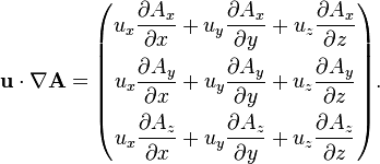

One thing I did notice is that I messed up by forgetting that in (u⋅∇) , ∂/∂x is not commutative, so I was doing (∇⋅u)u, which is different.
So now I'm getting
(u⋅∇)u = (ux, uu)⋅(∂/∂x, ∂/∂y) (ux + uy)
= (ux∂/∂x + uy∂/∂y) (ux + uy)
= (ux∂(ux)/∂x + ux∂(uy)/∂x + uy∂(ux)/∂y + uy∂(uy)/∂y)
Which I then apply to the given velocity field u = (y, t-x), to get:
Du/Dt = ∂u/∂t + (u⋅∇)u
= (0, 1) + (y ∂/∂x + (t-x) ∂/∂y) * (y, t-x)
= (0, 1) + (y ∂(y)/∂x + (t-x)∂(y)/∂y, y ∂(t-x)/∂x + (t-x)∂(t-x)/∂y)
= (0, 1) + ( 0 + t-x , -y + 0)
= (t-x, 1-y)
Have I gone wrong here?
I've found this on wikipedia, which seems to reflect the same process I've just used:
Thanks.

Something's gone wrong here. If \mathbf{u} = (u,v) with respect to cartesian coordinates (x,y) then indeed \mathbf{u} \cdot \nabla = u \frac{\partial}{\partial x} + v \frac{\partial}{\partial y} but <br /> (\mathbf{u} \cdot \nabla)\mathbf{u} = \left( u \frac{\partial u}{\partial x} + v \frac{\partial u}{\partial y}, u \frac{\partial v}{\partial x} + v \frac{\partial v}{\partial y} \right) and hence <br /> \frac{D\mathbf{u}}{Dt} = \left(\frac{\partial u}{\partial t} + u \frac{\partial u}{\partial x} + v \frac{\partial u}{\partial y}, \frac{\partial v}{\partial t} + u \frac{\partial v}{\partial x} + v \frac{\partial v}{\partial y} \right).
