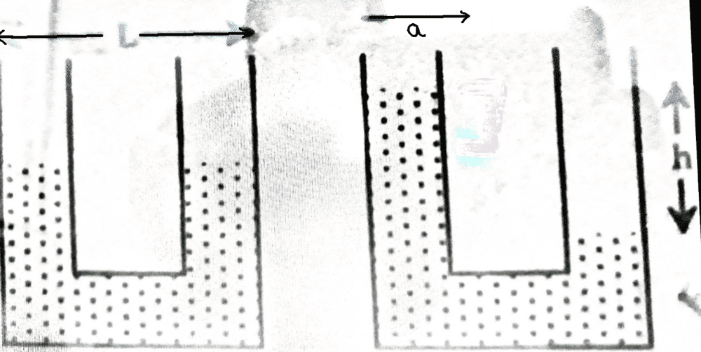

A U-pipe having uniform cross sectional area is filled with water. The picture on the left is when the U-pipe is at rest and picture on the right is when the U-pipe is accelerated with acceleration ##a##. Find ##a## in terms of gravitational acceleration, ##g##
##a) \left(\frac{2h}{L}\right)g##
##b) \left(\frac{h}{L}\right)g##
##c) \left(\frac{h}{2L}\right)g##
##d) \left(\frac{h}{L}\right)^2 g##
##e) \left(\frac{2h}{L}\right)^2 g##
ΣF = m.a
P = F/A
P = ρ.g.h
I am thinking of using ΣF = m.a to find the acceleration but I don't know what causes the resultant force to the right. I thought it will be the difference in pressure on the left and right leg of the U-pipe (picture on the right), which is ΔP = ρ.g.h but the force (ΔP . A) won't be directed to the right (it will be downwards).
What approach should I use to solve this question? Thanks

Pressure has no direction. It is only when you multiply it by an area vector (the vector being normal to the plane of the area) that you get a force vector.
So, what area do you think you need to consider?
I note that you are not given the width of the tube. You will need to assume it is small compared with L, despite the drawing.

Since the pressure is hydrostatic pressure, I think the area should be the cross sectional area of the U-pipe and area vector will be vertical so the resultant force produced will have vertical direction (downwards)

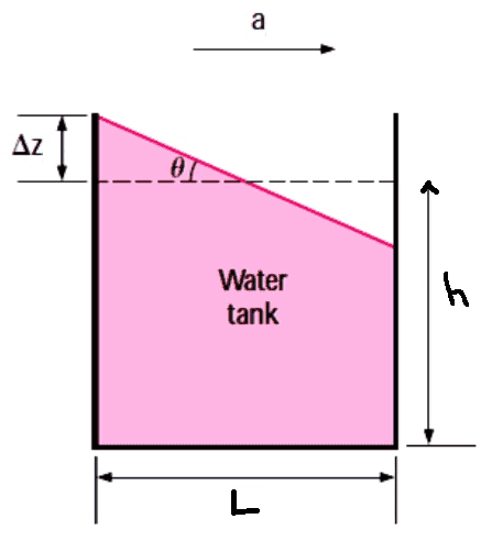

Based on @haruspex suggestion to assume L >> width of tube, I assume the U-pipe will look like this when being accelerated:
##h## = height of water surface when the container is at rest
##\Delta z## = rise in water surface
$$\tan \theta = \frac a g$$
$$\frac{\Delta z}{\frac{1}{2}L}=\frac a g$$
Is this correct? If yes, how to relate ##\Delta z## to ##h##? Thanks

Think about the bottom (horizontal) section of water (length L on your diagram) in isolation: call it 'B' (for 'bottom').
The unbalanced forces acting on B are the horizontal normal reactions of the walls at each end of B, magnitudes ##N_{left}## and ##N_{right}##.
The resultant force on B is ##N_{left} - N_{right}## to the right . This is the 'F' in 'F=ma' when considering B in isolation.
If the cross-sectional area of the pipe is A, the pressures at the ends of B are ##P_{left}=\frac {N_{left}} {A} ## and ##P_{right}=\frac {N_{right}} {A}##.
Since there is no vertical acceleration, the pressure at the left end of B is ##P_{left}=\frac {\rho g h_{left}}{A} ## and at the right end ##P_{right}=\frac {\rho g h_{right}}{A} ##.
Once you understand that, the rest should be straightforward.
The error in this diagram is the magnitude of h, which should be the height difference between the highest and lowest points of the free surface.
Ah ok, so the result will be: ##a=\left(\frac{\frac{1}{2}h}{\frac{1}{2}L} \right)g=\left(\frac{h}{L} \right)g##

I think these two suggestions are the same. Considering each end of the horizontal section, the Newton's 2nd law equation will be:
$$N_{left} - N_{right}=m.a$$
$$\rho ghA=\rho ALa$$
$$a=\left(\frac{h}{L}\right)g$$
Thank you very much for all the help haruspex, Lnewqban and Steve4Physics
