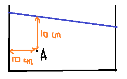

I draw this diagram:
Hand-drawn sketch of a tank of water with a tilted blue free surface, a point A marked near the bottom, and orange arrows labelled 10 cm horizontally and 10 cm vertically from A.
The formula for hydrostatic pressure is: ##P=\rho g h## so I just plug everything
$$P=1000 \times 9.8 \times 0.1=980 Pa$$
Will the acceleration of the cart affect the hydrostatic pressure?
Another thing that came to my mind was there would be extra force coming from normal force between water and left and right side of the tank and since the tank is accelerated to the right, normal force from the left part of the tank is bigger than the right part causing net force to the right.
But I am not sure whether I need to consider this to answer this question and how to proceed.

Are you sure you are not supposed to measure ##10 \, \rm{cm}## deep as from the point on the wall where the water touches it on the far left? I believe this problem is leading you to find the slope of the water due to the acceleration of the cart. The depth will not be ##10 \, \rm{cm}## from surface in that case, you will have to determine it. Like you say, the problem is trivial otherwise.

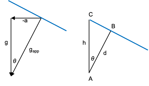

I set up Newtons Second Law in a non-inertial frame, the coordinate ##x {}^+\leftarrow## is fixed to the front of the cart. The entire cart is accelerating to the right at ##a \rightarrow^-##. Look a thin vertical cross-section of length ##dx##, height ##h(x)## and mass ##dm##.
In the non-inertial frame of the cart there is an apparent acceleration of gravity vector $$\mathbf{g}_{\text{app}}=\mathbf{g}+(\mathbf{-a}).$$The surface of the liquid is perpendicular to the apparent acceleration vector. To find the pressure, you need to find the perpendicular distance ##d## from point A to the surface, then use $$p=\rho~g_{\text{app}}~d.$$You can read more about apparent acceleration of gravity here if you wish.
kuruman said:
find the pressure, you need to find the perpendicular distance d from point A to the surface, then use p=ρ gapp d.
You don’t, actually. If the situation is as depicted it is something of a trap to make you think you need to do all that. However, in an incompatible fluid in a constant gravitational field ##\vec g_{\rm app}## the pressure difference between two points separated by ##\vec d## is ##\rho \vec d\cdot \vec g_{\rm app}##. If you pick your reference point as OP did, then ##\vec d \perp \vec a## and ##\vec d \parallel \vec g##. Therefore the pressure difference is ##\rho g d##, where ##d## is 10 cm and ##g## the regular gravitational acceleration.
Alternatively you can reach the same conclusion by looking at the similar triangles for the distances and accelerations.

Is the shown sketch coming from the problem or you draw it yourself?
I draw it myself, there is no picture from the original question

I interpret it as 10 cm from the surface of water which is now slanted because of the acceleration
Lnewqban said:
From which wall of the tank?
I don't know so I just take one of the side
10 cm down from what point on the slanted surface?
Like what I draw in OP
Thanks

Which, with the OP’s interpretation of the problem (with the 10 cm depth being measured from the surface right above the point) is not something you need to compute.

Neither is relevant. You have a reference pressure at the surface directly above the test point. You have a known gradient of pressure along a vertical axis. What more do you need?
I think it's either what you have already solved... a question which basically tries to trip you up
or
The tank is completely filled as @haruspex interprets, and you have to do some analysis.
The other possible solutions seem to leave out too much information about where specifically this test point is relative to the walls.

The point is, you only need the component of the pressure gradient in the vertical direction, which makes the acceleration irrelevant.

I believe in the case where it is an open top tank as drawn by the OP, the pressure at a depth (vertically) ##h## from any point on the surface is just ##P = \rho g h##.
The pressures from the acceleration and the hydrostatic pressure must be additive to produce the slope of the water; If they didn't add together then why would it slope? If we draw a horizontal line at some depth ##h## as a function of ##x## the distance from the leading wall of the tank, then the pressure at any point on that line is given by: $$ P = \rho g ( h + \frac{a}{g}x )$$ But if we draw a line parallel to the surface at depth ##h## from the leading edge the pressure at every point on that line is just: $$ P = \rho g h $$

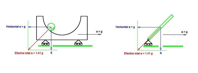

The way I see it:
These two graphical situations are comparable to this problem in principle, if some relation can be established among static pressure inside the fluid in equilibrium and the total reaction of the represented bodies, also in equilibrium, at the support point.
The value of the unique static pressure at certain point inside the fluid, which is reacting to the horizontal acceleration of its container, can't be the traditional ρgh (pressure gradient in the vertical direction).
That point is supporting the force (each mass x common diagonal acceleration) of all the molecules that are aligned with the resultant acceleration vector and located between that point and the surface.
Two diagrams of a container accelerating horizontally with a ball or tube inside; blue arrows show Horizontal a = g and g downward, red arrow labelled Efective total a = 1.41 g.
