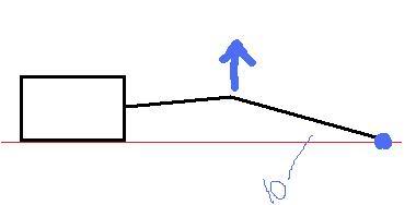

What about this though?
Its the same box, but I don't know how to set this up. Isn't the angle changing as he's pulling the rope upwards?
yes, in that example it is. However, in the first example that you posed; he is pulling parallel to the angle of the chain. Therefore the angle of the chain is NOT changing but there is still an X and Y component of force.
Yeah, I know in the first one it wasn't changing. How would I solve this one though?
What are you given, and what is the question asking?
It's the same question. Only now he anchored the cable to a point (the blue circle on the right) and is pulling the rope upwards. The 10 degrees refers to the angle the rope makes with the ground at the point where it's anchored. Same box (200N).
And the rope attached to the crate is horizontal?
It's not parallel to the ground in the book... So I guess not.
