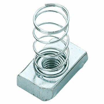

Right. The normal force at any point along the thread is perpendicular to the track of the thread. It has a non-zero component parallel to the axis of the bolt.
Picture a bolt inserted through this spring and threaded into the nut.
Product photo of a zinc-plated spring nut: a rectangular metal block with a threaded hole, with a coil spring of round wire rising from its top face.
If the normal force is perpendicular to the track of the thread then, how the nut may push the screw fastener (or vice versa) in order to advance? This is the reason what I shared on my first post that the action and reaction forces should tangential to the threads of the nut and the screw fastener. Otherwise, motion cannot occur.

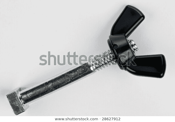

Most easily visualized for me as a wing-nut on a smooth bolt. Give that wing nut a good flick and it'll spin a long ways down the bolt.
