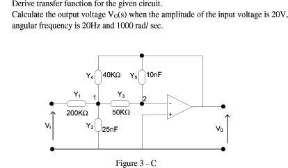

hey I put some filter what will be the out put of this?
is it depend on y3 or depend on y4 and y2?
im very confusing in here...
can anybody help me?

I would expect the transfer function to involve all elements Y1-Y5 shown. Are you able to determine the transfer function? That's how you find out.
It looks like it will have a lowpass characteristic.
