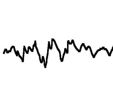

For my time series and spectral analysis class i need to graph something like in the attachment. i need to have 100 numbers that are connected like that, and then 'add' them to a sinusiodal wave to create a real life wave - with noise.
How would i do this using mathematica??
I can easily generate a whole bunch of random numbers with ranging values but how would i make it such taht all the numbers are in ascending order and go from 0 to at least 2 pi?
would i use numerous Random[x] and then arrange them (how?) in ascending order??

I have no idea what you mean, ascending order. From what I can tell, there's no correlation between the time and the value, which is rather the definition of a random variable. You're not going to add the random values to the angles going into the sine function -- you're going to add them to the outputs coming from the sine function.
Just compute a table of sine values, one for each point of interest. Next, add a random value to each entry in the table.

now why didnt i think of it that way
in fact tahts what my prof said too
im just silly
thanks a lot :biggrin:
