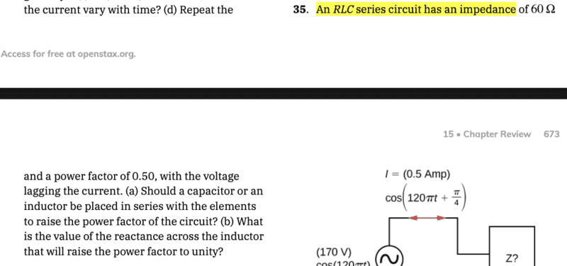

An RLC series circuit has an impedance of 60 ohms and a power factor of 0.50, with the voltage lagging the current. (a) Should a capacitor or an inductor be placed in series with the elements to raise the power factor of the circuit? (b) What is the value of the reactance across the inductor that will raise the power factor to unity?
##P = 0.5\times IVcos(\phi)##
##Z = \sqrt{R^2 + (X_l - X_c)^2}##
a) An inductor should be added because that would cancel out the lag of the voltage with the current so that P = IV is at a maximum since V is ahead of I in an inductor
b) ##cos(\phi) = \frac{R}{Z}##, ##R = Zcos(\phi) = 60\times 0.5 = 30 ohms##
##X_l - X_c = \sqrt{Z^2 - R^2} = \sqrt{60^2 - 30^2}## = 52 ohms... don't know how to solve any longer
Unity power factor means ##cos(\phi) ## needs to be equal to 1, so there is no lag or lead b/w voltage and current. 🤔

Yes, I am adding an inductor with ##|Z_{L'}| = X_{L'} = -52## so that ##X_L - X_C## = 0
OK, I'll give you a break on the whole sign thing. Except to point out that magnitudes are never negative and inductance is never negative. Reactance can be negative, but that would be a capacitor with a non-negative capacitance. This is an important issue for you to get straight someday, but will be easier when you are comfortable with complex impedance values.
So, yes, adding a series inductor with a reactance X = +52, or and inductance of L = 52/ω will give you unity power factor.
But... Now that I've finally read the question carefully, I wonder if you copied it correctly? Part b) asks "What is the value of the reactance across the inductor that will raise the power factor to unity?". Compensating the reactance by adding a component "across the inductor" isn't a solvable problem without knowing the value of the original L or C, we only know the net reactance, the difference between the inductive and capacitive parts.
At best it's a poorly worded question. All we can know is that we have to add, not what the original individual reactive values were.
This is the problem exactly (#35):
SammyS said:
Be careful in solving this equation, ##~~\displaystyle Z = \sqrt{R^2 + (X_L - X_C)^2} ## ,
especially when solving for ##X_L-X_C## .
Squaring both sides gives : ##~~\displaystyle Z^2 = R^2 + (X_L - X_C)^2 ## .
Solving for ##(X_L-X_C)^2 ## gives: ##~~\displaystyle (X_L - X_C)^2 = Z^2 - R^2 ## .
When taking the square root of both sides, you must remember to supply a ± sign.
So you get ##~~\displaystyle X_L - X_C = \pm\sqrt{Z^2 - R^2~} ## .
The sign is determined by knowledge of what is lagging or leading.
Voltage versus Current
I see, since voltage is lagging current, there is more of capacitor voltage and less of inductor voltage, leading to the negative sign of ##X_L - X_C##, so you have to add ##X_L## of +52 ohms
Yes.
I'm also not sure if "the value of reactance across inductor L1" refers to the reactance of L1 itself or the reactance of another object externally connected to L1. But if it is the latter, there is no way to answer the question. So I have no choice but to assume that it actually refers to the reactance of L1 itself.
annamal said:
I see, since voltage is lagging current, there is more of capacitor voltage and less of inductor voltage, leading to the negative sign of XL−XC, so you have to add XL of +52 ohms
So I said in #6 that I wonder why you say you don't know how to solve ##X_L##, because you have calculated the correct answer in #1.
