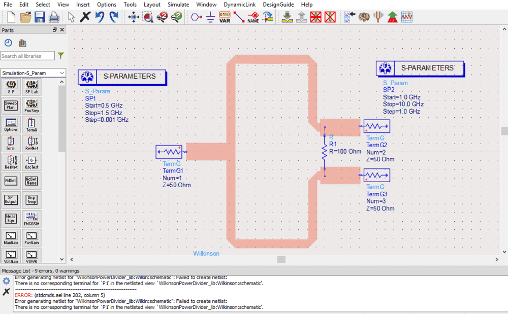

Hi all,
I'm new to ADS, so I followed a youtube video in designing a Wilkinson power divider to Co Simulate. I was able to get through the EM simulation part, but I am getting the following error in the schematic simulation portion:
"There is no corresponding terminal for `P1' in the netlisted view "
Any help will be much appreciated.
Tadeh
Can you show the Netlist View? What is P1 supposed to be?
Thank you for responding. Someone helped me and it turned out I had a schematic created in the same cell as the layout, and in the meantime I was trying to simulate the testbench in a schematic in a different cell, and apparently that is not okay. Deleting the extra/empty schematic in the EM layout cell solved my problem.
Thanks,
Tadeh
thanks a lot for the post, it also helped me.
