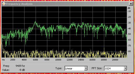

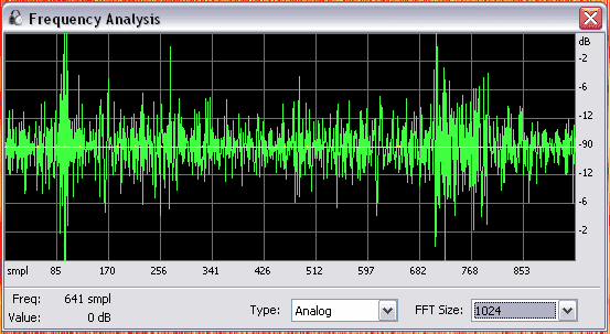

On my Subaru late last winter, I added a turbo/intercooler and a MegaSquirt engine controller. The car ran good after some tuning but on a hot day in summer I heard the engine detonate badly. I connected my laptop's microphone to the knock sensor and recorded engine knock.
Here is the time domain signal
Here is the frequency domain of that signal - ignore the yellow signal.

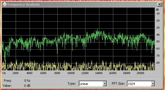

And here is the frequency domain of regular engine noise
It was very obvious for me to go after the spike at 5.9 kHz to determine if the engine is experiencing detonation.

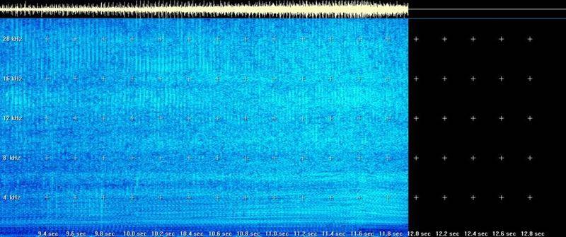

There is also a rolling display of frequency domain.

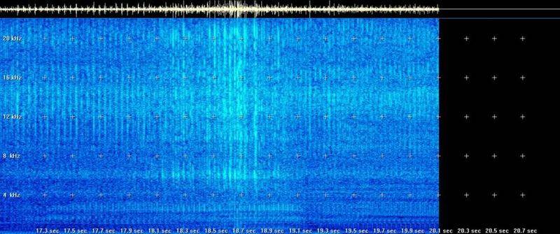

Here is the engine being reved up
and here is detonation while being reved
The cool thing about frequency domain is that you get to see all the sounds.
