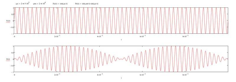

Question about AM! What is the amplitude of silence?
Just the carrier, at whatever level the signal strength is at your location.
As the carrier amplitude changes how long does it take the receiver to "recalibrate" (if that's the right term) to the new carrier strength? How long does it take the receiver to sort out "new carrier amplitude" from "these changes in amplitude are the signal"?
The carrier never changes in amplitude.

Ever heard of/experienced signal fading? In sever cases it is called a 'dead spot', as when your receiver (phone, for instance) cannot detect the transmitter.

This is a real overstatement of 'the facts'. It all depends on the bandwidth that you are measuring it with. With the appropriate deviation and a sinusoidal modulation, the amplitude of the carrier component of the spectrum goes to zero. If you look at the table in this wifi link, you will see the amplitudes of various sidebands and at a deviation of 2.41, there is no carrier component. Ideally, the total signal power will not change, of course, but that includes al the FM sidebands. That 2.41 figure can be used (Bessel Zero Method) to calibrate the deviation, which can be a very slippery fish to estimate in practice.

Windmill blades will modulate the carrier that you receive but the modulation will be at an infra sound frequency. There's very little low frequency response of an AM receiver (unless it's been specially designed) so that's not likely to be an issue. Caveat here; if the blades produce really terrible minima, once a cycle, then you could conceivably cause 'cross modulation' of the blade rotation frequency onto every component of the programme spectrum. Very unpleasant and that can't be filtered at all easily - depends on how smart your receiver is.
You have to realize that Ancient Modulation is very ancient and is not suited to most purposes, except very local MF radio and some comms applications. But narrow band FM has replaced AM for the remaining ship to ship systems etc. at around 120MHz, although AM is still legal on the same bands I believe.
