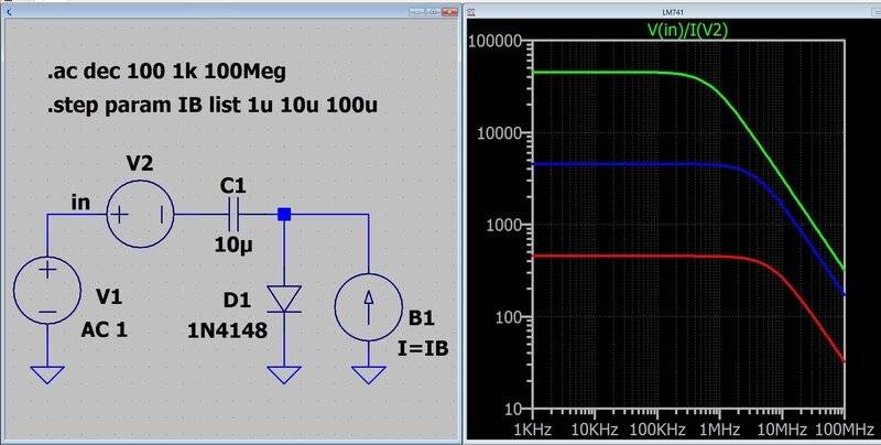

jsg2021 said:
The small signal is a pure AC source "for sure" but it only works for linear circuits. As soon as you put a semiconductor in, you either must "linearize" the semiconductor at a specific bias point (Q point) and specific set of independent, non-interacting frequencies, and then treat the entire circuit as a linear component with no nonlinear features
Calculation example of AC impedance of nonlinear diode 1N4148 after linearization under different bias currents.
It is worth mentioning that, do not try to add complex logic statements (If-Then-Else) or components with memory effects to the circuit, which may cause the linearization calculation results to be uncertain or deviate from expectations.
Yeah that's interesting if the model specifies nonzero CJO since I'm pretty sure that models varactor effects. Though it's probably an ideal varactor with infinite SRF... looks like that's true up to 100mhz at least.
