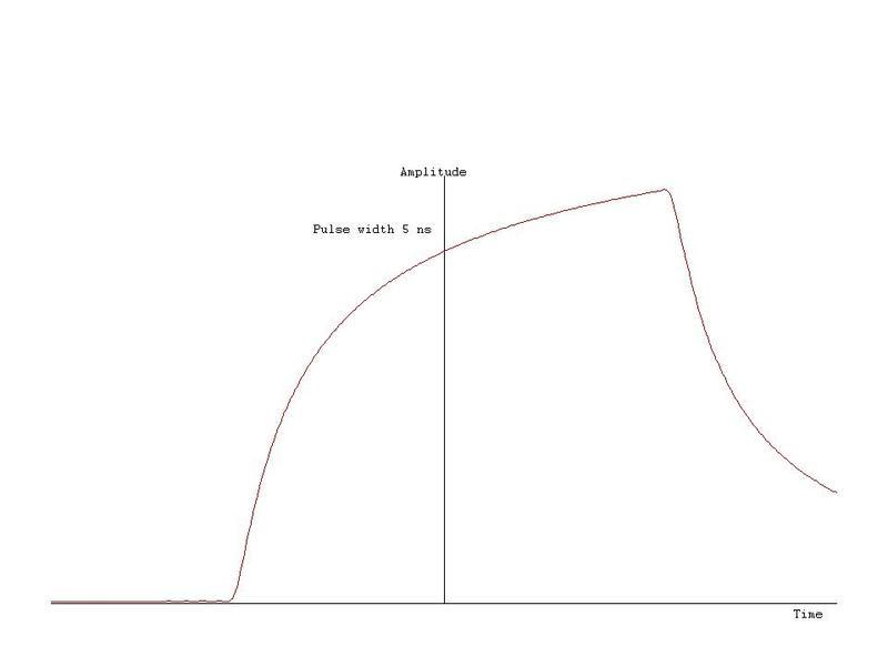

OK, I am going to push it a little more:
What if I hook up a light bulb with a loonnnng long wire half way across the world to connect to a switch and then to the +ve side of the battery. Then I connect the -ve side of the battery with a long long wire and keep going around the world ( not the same path as the original wire to the switch.) and come back to the light bulb. So the circuit is one big loop around the world. There is no wave guide to speak of, assume neither wire is connect to the ground ( no microstrip effect using the earth). There should not be TEM wave traveling along the wire. The only TEM wave is pointing towards the center of the wire according to Poynting vector where E is parallel to the wire, B is circling the wire and E X B = -r pointing to the center of the wire.
Now how come the light still turn on so fast?
yungman said:
I see, thanks for your help. So everything is EM! Is it Fourier Transform you refer to instead of Laplace?

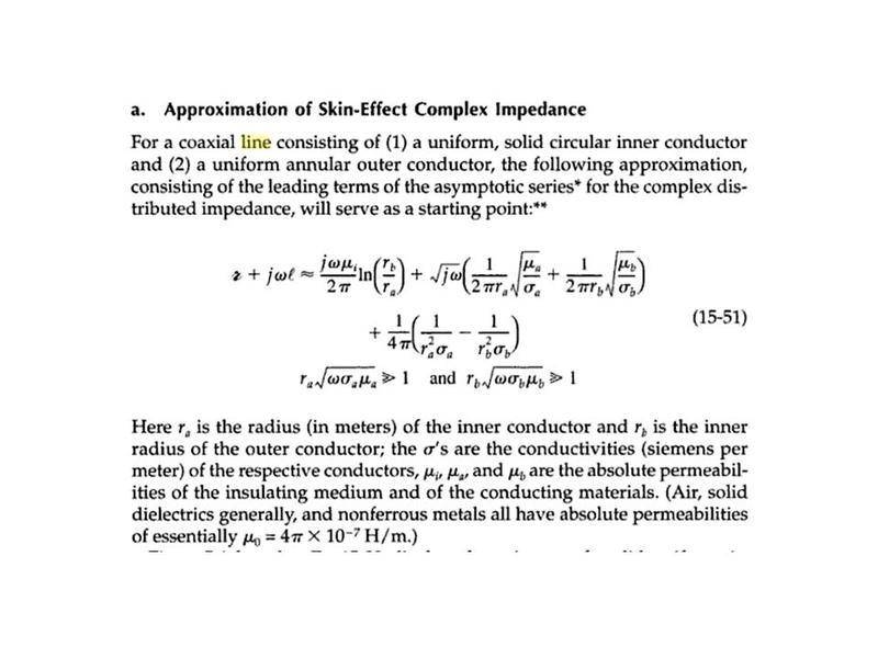

The book Transmission Lines and Wave Propoagation (4th edition) by Philip Magnusson is the best book I know of that discusses transmission lines. Few books discuss skin effect losses properly.
Chapter 5 discusses the Laplace transform of step functions in transmission lines, using the skin loss approximation shown in the first thumbnail. Because √(jω) = (1 + j)√ω, the skin effect loss causes both an attenuation (measured in nepers) and a phase delay (measured in radians). This √f frequency dependence of losses is rather difficult to use in Laplace transforms however.
For this particular case, it is easier to use a Fourier series expansion. A square wave is represented by the series sin(nα/(nα). In thumbnail 3, a 5-ns pulse on a coax with skin effect losses is shown. The code for this pulse is shown on thumbnail 2.
Bob S
