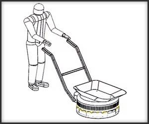

Sounds like you should add a skirt, like a hovercraft uses. Otherwise it will take WAY more power to lift the load that high.
Make a Hovercraft Wheelbarrow, like this:
