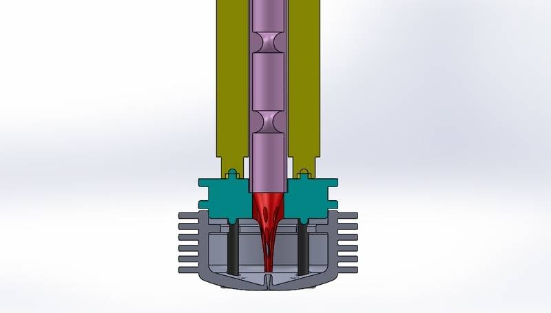

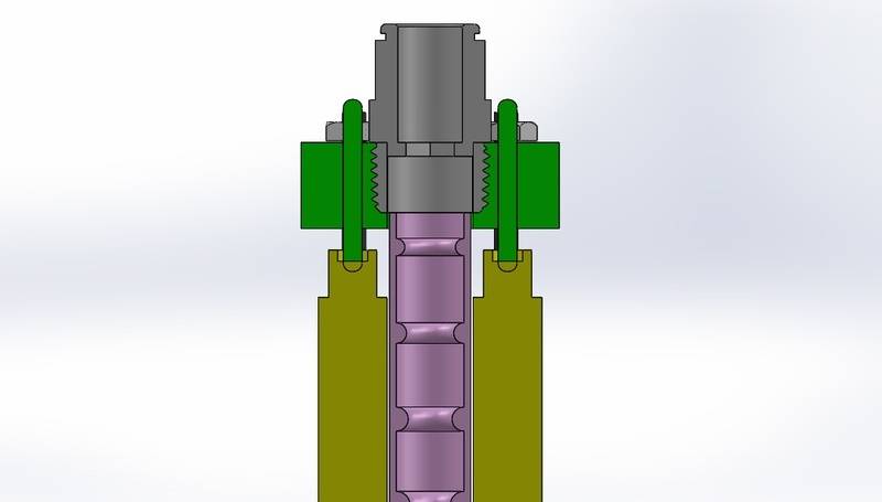

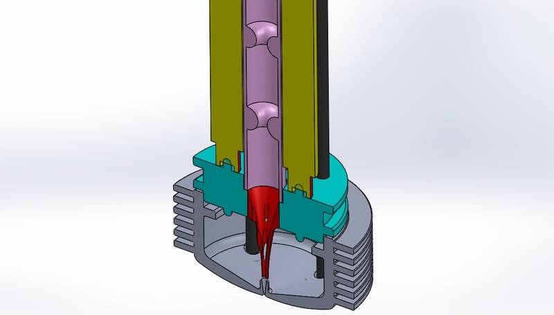

Greetings PFers,
I'm working on a project where micron size metal or plastic particles are carried inside an argon or nitrogen stream at ~1 atm. The particles travel through at 1/4'' ID nylon tube before they enter a chamber where they then travel through a pyrex tube. I have four 4'', 500W halogen light bulbs around the tube perimeter that are meant to heat up the airborne particles to their melting point.
My problem is the particles enter the heater chamber with a stream diameter of 1/4''. I need to focus those particles down to under 0.02 in. Due to the hot nature of the chamber, stray particles will inevitably adhere to the glass tube and eventually clog the system. I'm trying to find an aerodynamic solution to my problem. OR, find a way to use the halogen heaters as an electron sprayer and have high voltage plates to focus the now charged particles into a small beam diameter.
Is there any way I can get the electrons to pass through the glass walls of the halogen bulbs and impact the particle stream?
Image notes:
yellow objects are the halogen bulbs
Pink object is the pyrex tube with focusing rings
blue objects are the insulating caps
grey object on the bottom is the final focusing chamber where the air is removed from around the particle stream.
grey object on the top is a push to connect fitting
Black objcts are stainless steel rods holding the assembly together

The focussing of a particle stream using electrostatic or magnetic fields will be sensitive to variation of the mass of the particles and variation of their charge.
If the nozzle that extrudes the particles in the gas stream then by connecting that nozzle to a HV DC supply would generate charged particles. That is powder coating or spray painting technology.

Regarding the heat source as a source of charge, I doubt very much that you will get a significant charge through the glass tube.
An ellipse has two foci. If your light source is at one focus and the particle stream is at the second focus then you will have very efficient heat transfer. With four axial light sources in four partial elliptical cylinders you can move the heat sources some way from the particle stream and improve the efficiency. You will need forced air cooling through the light chambers, that is, outside the inner pyrex tube. Because the light is convergent on the particle stream it will pass through a wide area of the pyrex tube wall. A laminar inert gas flow on the inside surface of the pyrex tube should help to keep it clean.
I cannot see a better heat source than your quartz halogen light tubes, apart from the addition of the partial elliptical mirrors. The pyrex tube is needed to isolate the violent cooling air from the controlled particle stream. I believe all those are now “givens”.
So the focussing challenge can now be considered a fluid dynamics problem inside the pyrex tube.
Having a number of smaller particle jets converging about the central axis would result in a tighter helical flow along the axis of the cylinder. I believe that would be more stable and hold the stream together better.
I now have an 8 hour drive ahead, acoustic focussing of a helical stream will give me something to think about.

I had envisioned a parabolic or elliptical mirror on the outside of the four halogen bulbs to reflect the outward rays.
I'm not sure how hot the halogen bulbs can get. If the quartz glass and ceramic insulators cannot withstand the high temperatures, I will need to add forced air (assuming the mirrors don't melt...). If I do that, ceramic fiber insulation on the outside will not be needed.
The multiple particle streams necessary for a helical flow would not be difficult in my application, but the particle density in the individual streams will not be constant. However, I'm confused as to how a helical stream of airborne particles can exist in a laminar flow due to their swirling nature.

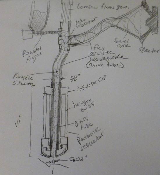

Acoustic Focusing
Thanks for the references Bobby, but I'm going to try and avoid PZ elements because of the technical difficulties in my application. We've concluded electrostatic, magnetic, aerodynamic and now PZ aren't the best options, so i'd like to focus on acoustic waves (longitudinal or transverse)
Because nobody seems to know wither or not longitudinal waves indeed give rise to transverse waves which would coaxially focus the particles, it seems an experiment is in order. Unfortunately that will take a while to setup.
For an acoustic waveguide that generates a standing wave, i'd need a rectangular or circular (I've chosen circular) tube with a diameter just under 1/2 the wavelength (making that just under 1/4'') and a waveguide length some integer multiple of the wavelength. The waveguide material needs to be stiff, but can be flexible.
Can I use a 1/4'' ID nylon tubing for the waveguide? As long as it doesn't get kinked, wouldn't it work?
I'll model what I'm thinking here and post a picture...
I've attached what I've got in mind for acoustic focusing. It separates the powder injector and focusing source from the heater chamber. The tubing is 1/4'' nylon.
Any obvious problems?
Thanks!
-Tay
It is important that your reflectors are elliptical. If they are parabolic then opposite light sources will heat each other, but not the particle stream.
With partial elliptical reflectors each light source will have a halogen tube at one focus, and the particle stream at the other. The lights will indirectly heat each other, but only after being intensely concentrated on the particle stream.
The attached cartoon sketch shows a “tweeter” speaker mounted in a tapered waveguide that looks a lot like the Bromer Sound Transverse Waveguide. Its purpose is to act as a speaker cabinet to produce bass frequencies. In this invention a bass speaker is mounted inside and directed inward near the closed (smaller) end of a truncated radial waveguide. “The waveguide then mimics a portion of the surface of a large, pulsating sphere and a portion of the air surrounding it.” (from Patent No. US 8,066,095 B1) Thus bass frequencies are radiated outward from the open (large) opening.
In the drawing you’ve shown, however, the large end is closed and the small end is open where it enters the stream tube; just the reverse of the Bromer invention. You propose using a tweeter as a sound source of ~38kHz. Even though this structure is intended for bass frequencies, the ultrasonic frequency may indeed exit the small end (open) waveguide and enter the gas/particle stream. But there is no reason to believe these acoustic waves will induce longitudinal (axial) standing waves in the stream column (tube). Even if they did form an axial acoustic standing wave field it would tend to cause “bunching” of the particles into groups at the wave node sites.
I only expect a standing wave to be generated in the tweeter waveguide. With my current configuration illustrated in my last drawing, it would indeed be impossible to generate a standing wave parallel to the air flow without a cap at the bottom with a small orifice for the particle stream. I might end up putting a cap on the bottom to increase the amplitude of the (assumed) transverse waves.
