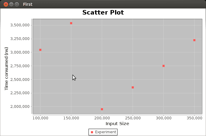

Twice I have had to calculate the speed of algorithms depending on input size. The first time I was working in MATLAB(which is based on C) and was timing the difference in time to perform matrix operations on the identity matrix in standard storage and in sparse storage, as I grew the matrix size.
More recently I have been testing (for increasing array input sizes) the running time of the bisection search and the linear search in the worst case.
In all the above experiments I get correct results, for example for bisection search it increases linearly with array size. For bisection search I get a graph looking like log(n). For matrix multiplication under standard storage, operation time increased exponentially, and under sparse, some function of log(n) was observed.
HOWEVER, in all the above experiments the input size was increased AUTOMATICALLY with a loop, and left for a few hours to automatically generate all data. For example, for the linear search it would increase it by 50000 inputs and always look for the element in the last position.
The first call of the searching function/matrix operation always takes much longer than the rest. Only thereafter do I observe the expected trend. In the case of linear search it is always the first two calls of the function.
In the case of MATLAB for matrix operations the algorithms were most definitely correct; it simply consisted of timing A*B with

In the case of the search algorithms I've verified I've coded them correctly. I am using
Code:
System.nanotime
to time the algorithms.
Why does the first one(or two) runs take so long, while the expected trend only follows thereafter?
I am not running any other software at the same time, nor doing anything other than letting the algorithm run. I do not have a screensaver; UBUNTU just switches off the screen after a while. I have an Intel Celeron 2.13Ghz, and 2 gigs of DDR 2 RAM
For the java bisection search and linear search I am using an ArrayList datastructure. Note that to get() operation on the array list it is O(1) and this is the only operation I perform on it during the linear search.
Also note, that the input size seems to be sufficiently large. It takes a good 15 minutes to sort lists of this size ascending before running and timing the bisection search algorithm.
I have an attached an image of linear search results. You can see after the first two loops it starts following the O(n) trend(for worst case scenario).
  • Screenshot from 2012-09-21 17:36:58.png

The first call might be getting impacted by cache loading or dynamic memory allocation when the list is being created, but I'm not sure why the second call would be slow. You could try running the first call twice in a row to see of the second instance of the first call runs faster.
The other but less likely issue is that your timer could be wrapping around on the longer calls. How long can the timer run before it wraps around? Do you know which timer is being used to generate these timings?

A fresh list is automatically created inside a loop, for different arraysizes. The code follows this pseudocode:
loop{
List of size 50 000 created.
Linear search performed and timed on this list.
List of size 100 000 created.
List of size 150 000 created.
etc...
} until user-specified number of list-size-increments are done
Does your above statement still hold?
I will still try running a call for size 50000 twice in a row later and let you know...

The timer takes the System.nanotime before executing the algorithm and after executing the algorithm to determine the duration. This is stored in a 'long'. The time to do a linear search is less than a second (observed) and the resultant duration from the program (a few millliion nanoseconds) corresponds to this. I am not entirely confident it is not wrapping around though. I will look into this as well and post back...
Code:
if(SearchType.contentEquals("LinearSearch")){
			System.out.println("Starting linear search...");
			long startTime = System.nanotime();
			int found_index = linearSearch(ready_array, query);
			long endTime = System.nanoTime();
			duration = endTime - startTime;
		return duration;
duration is of type long. The durations are later stored in an ArrayList<Long> for graph plotting.
