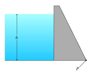

kawaiixsarang
Calculate the total force the Oahe Dam, placed on a structure by the reservoir behind it (in pounds and Newtons).
Oahe Dam: height=75meters, width=2835meters
Pressure = Force / Area
Force = Pressure x Area
Hydrostatic Pressure: Atmospheric Pressure + (Density x Gravity x Height)
Density of Water= 1000kg/m^3
Gravity= 9.81 m/s^2
- I can use Calculus on this, I know that... but I'm not in calculus yet, so I'm attempting to solve algebraically at least.
- I understand that pressure increases as the depth increases... so pressure isn't the same in all levels (right?)
What I tried doing is calculating pressure using (density x gravity x height) in every height...
For example,
(1000*9.8*1m) + (1000*9.8*2m) + (1000*9.8*3m)... so forth until I reach 75m.
Then I found force by using F=P*A...
the area would be (75m * 2835m)
& I get a total of 5.94 x 10^12 N as the force
BUTTTTT. I think the force is too high... =/
I should also consider atmospheric pressure, but I don't know where to include that (if I even should!)
PLEASE HELP MEEEE!
That is certianly one way to go about doing the problem. However...
Because 75m isn't very big in magnitude, and it's close to the Earths surface, then the force on a 'cube of water' due to gravity. Can be considered;
F=mg
Because our relationship for g is linear. Then we can suitably approximate it over the entire height of the dam.
So half of 75m is 37.5m
The presure at this depth is Rgh. So we find that the pressure is 3.68x105 and is the average value for the pressure over the entire dams area. Hence with the area in total being 2.13x105m2 the force is approximatly 7.82x1010 note I left out the atmospheric pressure. If we include that 101.3kPa is 1 Atmos.
Then the pressure at average depth is Rgh + Atmos. or 4.69x105, however remember that this same pressure is on the other side of the dam pushing back as well against the weight of water. Hence we don't really need to include it in the calculation.
The trouble with your calculation is that you are summing up sections of water that you have already calculated.
i.e. (1000*9.8*1m) + (1000*9.8*2m) + (1000*9.8*3m)...
The second term includes the first term, and the third includes the second and first. Which makes it inaccurate.
If you want to do it that way, it's an expansion of the Trapezium Rule and you should be doing each 'slice' seperatly. However I am quite confident that doing that is overcomplicating the problem. But I could be wrong.

Yes, that would give an answer ~75 times too high.
What you have done is add up the forces exerted on each
square metre in a vertical strip 1m wide.
To get the average pressure (force per square metre) you need to divide
by 75.
Or simply observe that there are 2835 of these metre wide vertical
strips in the wall, so multiply your sum by 2835 to get the total force
on the dam.
David
kawaiixsarang said:
thank you.
i tried doing your suggestion, so I got:
1000 * 9.8 * 75 = 7.35 x 10^5 as pressure
Then I added it on to 101,300 N/m^3 (atmospheric pressure)
and I did F=PxA like you said...
which gave me 1.778 x 10^11
but according to Haths... it should be 7.8 x 10^10
What am I doing wrong? =/
As tiny Tim said, the contribution that atmospheric pressure makes
to the water pressure is canceled out by the atmospheric pressure
on the outside of the wall.
1000*9.8*75 gives the pressure at the bottom.
What you want is the average pressure, which is half of this.
Now multiply by area and you get 7.8 x 10^10N

Hi kawaiixsarang! Thanks for the PM! :smile:
Easier to say (1 + 2 + … + 74) = 1/2 74*75 …
remember the general formula (1 + … + n) = 1/2 n(n+1)? :wink:
So the total is very nearly 1/2 752
and if you subdivided it even more, it would "tend to" exactly 1/2 752
However, I've just noticed another more intuitive way of doing it (without caclulus) …
turn the dam on it side! :biggrin:
then the force on each part of the dam can be represented by a weight of water of height h …
that gives you a triangle of water of height h and width h, and the total force is the total weight fo the triangle, which is … ? :smile:
Thank youuu! =)
I understand now. When I solve the entire problem I get out: 7.813e10 =)
