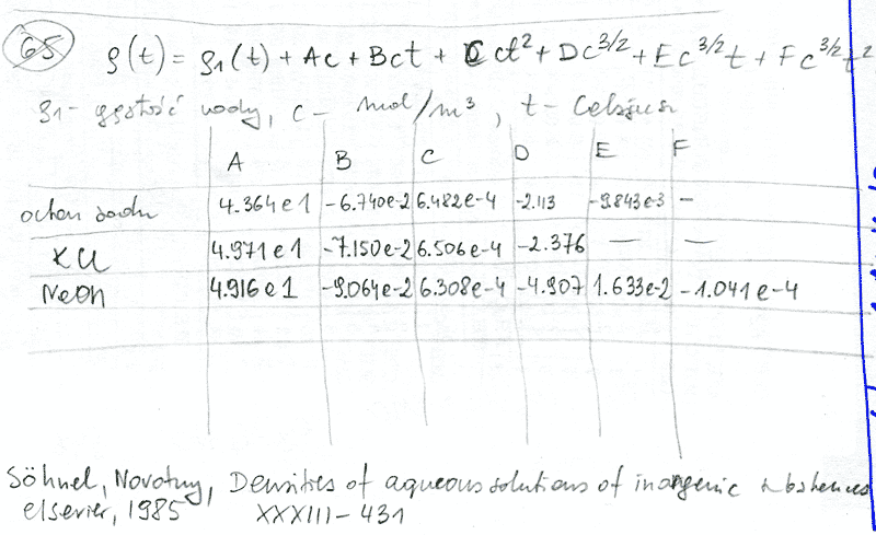

Yea so if you use the Atwood number equation you will see that I need a density of 1.071 g/cm^3 theoretically. Simply put, I want to achieve this theoretical density and I cannot figure out the concentration of salt needed in a saltwater solution. Rather than having an pretty good estimate, I would like to have a model where I can input a desired density and I can get out the required salt concentration. I could probably go ahead and run experiments with an Atwood number of say 0.0334 or similar but then I would not be able to validate my results with previous experiments. The results might even be valid, but with a 6% error, I do not think anyone will agree that it is valid. Also, it is very difficult to be precise with the amount of salt added. Especially when It gets to be a few kilograms of salt.
As far as I am aware there is no mathematical model of the type you are looking for. There are quite precise density tables published, and there is a book containing coefficients of highly precise curves fit to these data, but all I have here is this small note taken eons ago (it should help you see what it is all about):
1 is water density, octan sodu - sodium acetate, please note the way we write 1 and 7 here are different from the way they are written in US, and I am not necessarily consistent).
My CASC (http://www.chembuddy.com/?left=CASC&right=concentration_and_solution_calculator) does conversions of the density/concentration using a built in (and editable) density tables (for NaCl these are for 20°C) and using linear interpolation between the data points. There is a free trial version, so you can check if it is helpful.
