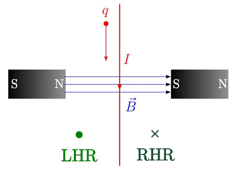

Fleming's left hand rule gives the force experienced by a current carrying conductor to point along the thumb, where the middle finger points along the current and the index along the (magnetic) field. The Lorentz force on a charge moving in a magnetic field is given by Fleming's right hand rule. Taking a moving charge in a straight line to be (crudely) as current, don't the two rules give opposite directions of force on moving charges?
Diagram of a vertical red wire carrying current I downward between two horizontal bar magnets with opposite poles facing, field B arrows pointing right; a red charge q moves downward above the wire; green dot labelled LHR and cross labelled RHR below.
Situation :
I have drawn the image to the right. A current ##I## flows "down" along a wire in a magnetic field ##\vec B## directed to the "right". By Flemings's Left Hand Rule (LHR), the wire should experience force out of the page, as shown by the green bullet ##\color{green}\bullet##. However, the current can be crudely approximated by a charge ##q## moving "down" with some velocity ##\vec v##. The force on the charge is given by ##\vec F=q(\vec v\times\vec B) ##.
By using Fleming's Right Hand Rule (RHR) for the same situation, remembering that this is a vector "cross" product, the force on the charge comes out to be into the page, as shown by the mark ##\color{OliveGreen}{\boldsymbol{\times}}##.
But how can this be? Which of the the rules above apply? Am I correct in assuming that current ##I## moving "down" is also the same as a (point) charge ##q## moving down with some velocity ##\vec v##?
charge q moving "down"
Positive or negative?

Positive.
Then you have applied the cross product wrongly: v x B points out of the image, not into it. So for a positive charge the force is also out of the image.

I don't see how. The RHR (Right Hand Rule) mind you.
The magnetic field is from left to right. Charge is moving down. Hence force points into the page, not out of it

Then apply the actual formula of the cross product and compute the output vector.
Note that this is the wrong order of inputs for the cross product. It's v x B not B x v.

Thank you and apologies. A silly error on my part.
Something else if I may. There's an agreement to take the conventional flow of current ##I## from positive to negative. In this problem I raised, namely the directiom of force in a current carrying conductor, the agreement becomes crucial. If you fancy taking current as the flow of electrons ##e^-##, you'd find the lorentz force to be indeed into the page (RHR), opposite to the force using the LHR.

What is crucial is that you are using a consistent set of conventions and formulas. But there are several possible sets that would work.

Yes. In the UK we are taught Fleming's Left Hand Rule for motor effect and Fleming's Right Hand Rule for Generator Effect. These rules use the conventional flow direction of electricity, which is from + to -. In the USA I think the Right Hand Rule is used for Motor Effect, and uses the electron flow direction, which is a source of confusion.

As I have found out only recently, and I confess I should have done so a lot earlier, it is best not to think of electricity as the flow of electrons ##(e^{-})## at all. The convention : ##\small{\text{electricity flows from positive to negative}}\; (+ \rightarrow -)## is more than an just an agreement. It is crucial to making the right and left hand rules work.
It is just an agreement. But to correctly apply hand rules which are based on that agreement, you obviously need to know what the agreement is.
