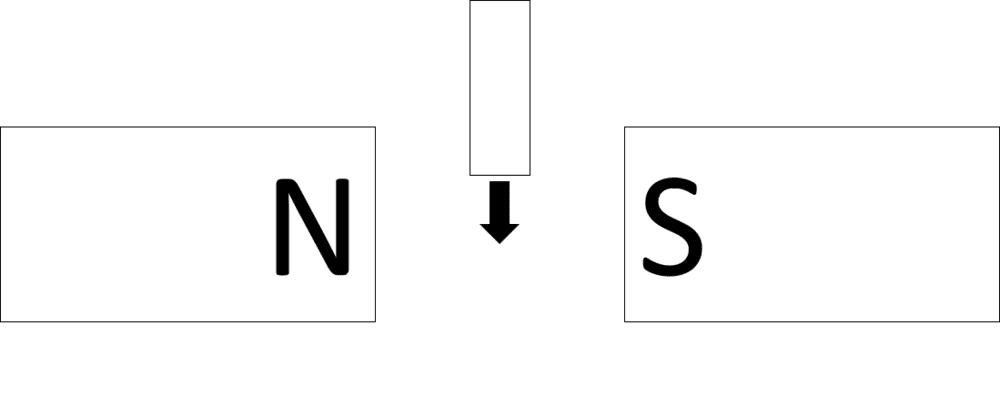

Hello all,
I understand the distinction between FLHR and FRHR. The LHR is used primarily for motors, while the RHR is used for generators/induced currents.
For a conductor moving between magnetic poles, we can use the RHR to predict the direction of the induced current. According to the diagram below (the conductor is moving downwards), using the RHR tells us that the induced current will be out of the plane of the screen.
241409
As I understand it, the rules (left hand and right hand) are referring to conventional current (please correct me if I'm wrong). So that means that in the example shown in the diagram, the direction of electron motion is actually into the screen.
If we could magnify the view of the conductor, we would see electrons. These electrons are in a magnetic field and therefore (a moving charge in a magnetic field) experience a force. Is it possible to use the left hand rule to predict the direction of the induced current (which should be opposite that of the motion of the electrons if both rules refer to conventional current) based on this idea?
If so, could someone please explain how.
Thank you in advance.
Why bring electrons into this? All this stuff was sorted out, way before the electron was discovered so don't call it 'conventional current'; just call it 'current' and don't add to the aggravation about EM - it's hard enough as it is. :smile:
PS you got the direction of the current right so leave it at that.

I can't think how you applied a RH rule when the LH rule applies - or vice versa if you use the standard directions for current, emf, field vector and motion or force. Which non-standard convention were you using for this rule?
The hand of the rule depends upon whether it's the Generator Rule (RH) or the Motor Rule (LH) that you are using.
