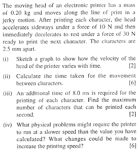

please help with this question.

actually, i can't even understand it. so, please try to help with this question
Which bit don't you understand?
Try describing the motion of the print head in your own words.

ok. sorry. when i tried again, i could do the calculations part
but can you explain to me the part iv. I got a lot of problems with the applications part. the only info I know about it is what is mentioned in the question
and also, for part (a), i needed to explain whether acceleration and velocity can be in different directions. for part (b), I had to explain whether resultant force and acceleration can be in different directions.
i think they should be related.
+ that part is 6 points. so, I don't think it's a simple reason.
so, please help me with that part

I don't know what answer they are looking for, but maybe noise, vibration, or heat buildup?
Perhaps something to do with the time required to start/stop/measure the ink flow to each dot?

during my calculations, i found times (for the forces) to be 8.66ms and 2.88ms
does this help?
ii was 11.5 millisec
and iii was 51.2 per sec
anyone please?
for iv) the most obvious thing is the actual time to print the character once the head has stopped moving.
As for what would you change to make printing faster... What factors effect how fast the print head accelerates?

It's an ugly question. You've calculated the print speed based on the data given. Why might it print more slowly? Because the data provided are unreliable?
If it is, e.g., a matter of heat build up, then the data should have been qualified, something like "in tests of printing a few characters..."
For speeding it up, based on your equations, which data modified in which directions, would increase the print speed?
Well, they've given you the mass, the forces and the distance the head needs to cover. You've got to know that everytime the printer gets ready to print a character, it's velocity is zero. But, force acts on it AFTER printing the character, so then you've got to calculate the velocity it attains while covering the distance to the next character (2.5 mm) just before the retarding force stops it again to zero velocity. So all you've got to worry about is one cycle of 'printing, moving and stopping', the graph will repeat itself. Use Newton's laws of motion with the proper signs for acceleration and you will get all the skeleton data required. The last part of the question is a real world scenario given to you, they've asked you for physical conditions, so perhaps it could be friction, heating, mechanical advantage loss due to improper parts and all that kind of stuff. So then you know what changes you have to make.

i've solved the problem. only the part o=about physical problems, ... i can't figure
as for the calcualtions, it's ok
I don't think there are any calculations involved...the numerical answer you computed only works in ideal situations (like zero friction, drag, etc). The answer to the last part must be qualitative not quantitative because they haven't given you any data to compute losses in speed due to the so called 'physical conditions'. So you've got to think of the real world and figure out what makes the printer work slower and suggest necessary changes.

Strictly speaking from the questions perspective perhaps the force acting to accelerate the printer could be increased, the actual head could be made lighter so it accelerates faster...etc (gosh am I breaking any guidelines!?)

Well I would try and make the print head lighter.
F=ma
so
a=F/m
A lighter head would accelerate faster so it would take less time to move between characters and give a faster print rate.
You could also increase the forces applied to the print head.
or both.
any other suggestion. because of the fact that the answer is 6 points. So, I'm thinking maybe there's some more complicated reason, but a reason that can be reached from the simple concepts that need to be known at A-level??
How about overshoot? I suppose if the drive system wasn't very "stiff" the head might carry on moving after the drive has stopped due to the inertia of the head. That might allow the head to overshoot the required position, or perhaps oscillate about the required position before coming to rest. So after commanding the head decelerate and stop you might have to allow a "settling time" for oscillation to die away before printing the character? I don't know if is an issue for real printers but it's plausible.
I thought of that, but shouldn't that be part of the 8ms already specified for how long it takes to print the character?
I knew a fellow who used to work in a printer test lab for a large computer company. He got thrown out of the lab for sending a printer a document in which each line consisted of a pair of characters separated by various gaps. He found the natural frequency and shook the printer apart.
Can't tell if they included that or not.
Personally I think most of the marks will be for explaining why the mass of the head is important.
So, to summarize, the only resultant points is to make the mass lighter. Or are there other reasons. I can't find the reason and change that needs to be done myself, but i personally i don't think this is enough.
someone mentioned something about the time to take ink. I don't know the physics of printers, but do you think this is a proper reason here. What about the 'electronic' printer as mentioned in the question?
Also, I think I forgot to remind you about the part for the sketch. Have you tried imagining how the graph is - it's simple. Maybe something might be concluded from the shape - it can be said that it has a periodic shape (the same shape repeats itself over and over).

by the way, I've been thinking. Are the magnitudes of the accelerating and retarding forces realistic to be produced in a printer? Or are they too large? Maybe that's oneof the restraints? What do you think? I don't know whether the forces are realistic or not though
if the forces are too great, would it possibly cause the whole printer to move?
is the time the head moves up and down to print already accounted in the question? or maybe this could be a reason for slower printing.
The old fashioned "golf ball" type printers may have worked like this but I don't think modern inkjet printers do. The latter just move the head at a constant speed from one edge of the page to the other. They don't stop the head to print a character they just print dots "on the fly". Those dots can form part of a picture or a character. eg there is nothing special about characters to a modern injet printer.
so, as a reason, may I say that allowing the head to move at constant speed would be quicker? this involves less mechanical work (I think) - there won't be a need to produce forces that causes accelerations and decelrations - so less friction, less heat, ...
