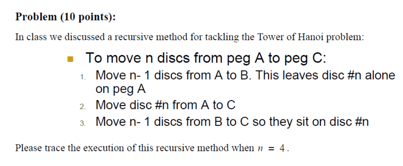

So I think this HW problem is very simple, but it is too simple that I am afraid I will do it wrongly.
Homework problem text: Problem (10 points). In class we discussed a recursive method for the Tower of Hanoi: to move n discs from peg A to peg C, move n-1 discs from A to B, move disc #n from A to C, then move n-1 discs from B to C. Asks to trace the execution when n = 4.
My Dr. said we don't need to know the C++ or any other cmputer language to do this question and he tell us to searh what is the meaning of "trace" in order to do this question.
But I found it difficult to understand on the web(most of them contain computer language)
My thought is that, substitute n=4 into the 3 statements, then it's done.
But it contain 10 marks! So I better ask it.
  • Homework problem text: 'Problem (10 points)'. Recursive Tower of Hanoi method: to move n discs from peg A to peg C, move n-1 discs from A to B, move disc #n from A to C, move n-1 discs from B to C. Asks to trace execution when n = 4.
I would think you'd write a list--of each step as you execute it--until you can write "Finished!" Of course, you won't write the letter n each time, you'll write a numeral. :smile:
And if you are chasing marks, you might draw what the two towers look like after each move. :smile: :smile:
