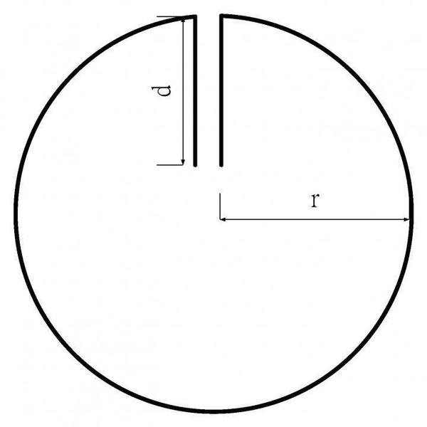

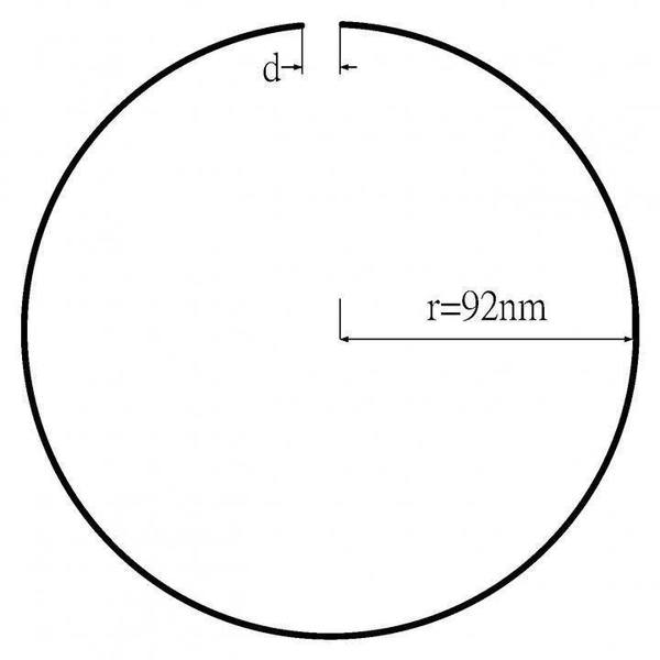

I am trying to solve the following two antenna.
Perhaps they have already solved in some textbooks. Could anyone advice me where can I find them?

They are both loop antennas, one has a feedline. It will depend on the frequency of operation ?
They are very small antennas so maybe they are smaller than a wavelength ? Terrahertz, infra red ?
I assume they are fed at either the gap or at the end of the transmission line section ?
Are they operated in free space or are they metal antennas on a dialectric substrate with a ground plane ?
The sectional size of the material will be important, as will the length and impedance of the parallel wire transmission line in wavelengths.
For long wavelengths they will have far field dipole patterns and a low input impedance.
What solutions do you require for what frequency ?

I am a physicist with basic training from Jackson's book on "classical electrodynamics" (no further on antenna)
I only got this fantasy a fey days ago.
What follows are my reply to your answer:
The wavelength of operation should be around 800 nm to 900nm (which corresponds to arround 300-400THz?)
Will the feedline of a loop-antenna change the characters of a loop-antenna?
It will function as a receiver (but normal antenna should be the same whether they are receiver or transmitter.)
Therefore, receiving at the gap or at the end of the feedline.
For the first step, I am only looking for whether can I solve it, therefore for simplicity only consider in vacuum, copper or some good conductor.
Maybe, later I can consider it in water etc.
I think an analytic solution should be possible since in Jackson's book there is a solution for a center-feed linear antenna.
I only changed it into polar-coordinate, for the first picture without feedline.
For the antenna with feedline, I am not sure whether it can be solved analytically or not?
Perhaps, with some superposition methods?

Solve it for what ? Impedance or pattern, electric or magnetic, near or far field ?
Both will be dependent on environment and construction.
There are simple analytic solutions for small isolated loops in most books on antenna theory.
Find a copy of "Antennas" by John D. Kraus. See chapter 6.
I am trying to get a copy of that book. But the internet version is very poor quality.
I want to solve Firstly, electric and magnetic field other quantities should follow.
I think far field is more interesting for me, since I am considering a receiver.
I saw in the poor version I got there is indeed solution for loop antenna.
For my wave length and antenna diameter it should be the "small-loop" case.

The Reciprocity Principle says the transmit and receive patterns are the same.
You should not be considering "power" so much as "gain" relative to a dipole or an isotropic radiator, dBi.
Impedance matching is essential if energy is to be absorbed, rather than be reflected by the antenna.
You need to read up on anti-reflection coatings and quarter-wave matching transformers.

Sorry I cannot provide the solutions you ask for but I can offer practical knowledge.The first antenna is the same as used by Heinrich Hertz when he first demonstrated radio waves. So it has been around a while. In both cases, the resonant wavelength is approximately twice the lengthy of conductor (actually a little longer, especially in case 2). In some cases for antenna 2, the end stubs are placed closely together, and may then have a loading effect, lowering the frequency, more than would be expected from their length.
The effect of the feeder depends on how you wish to couple it. This is a problem because the impedance across the open end is very high, much more than any transmission line. Hertz was not concerned about this because he was looking for a high voltage across the open ends.
Methods of effecting a match to a typical line include breaking the antenna conductor in the middle and making a connection there, or using a small coupling loop. The radiation pattern for all these antennas when mounted in a vertical plane is figure eight shaped in the horizontal plane and roughly circular in the vertical plane. The polarisation is essentially vertical.
It is commonly found that the pattern is distorted due to feeder radiation, and may be asymmetrical.
The gain of the antenna is basically that of a dipole, but due to the small size, we must expect a few decibels of ohmic loss.
