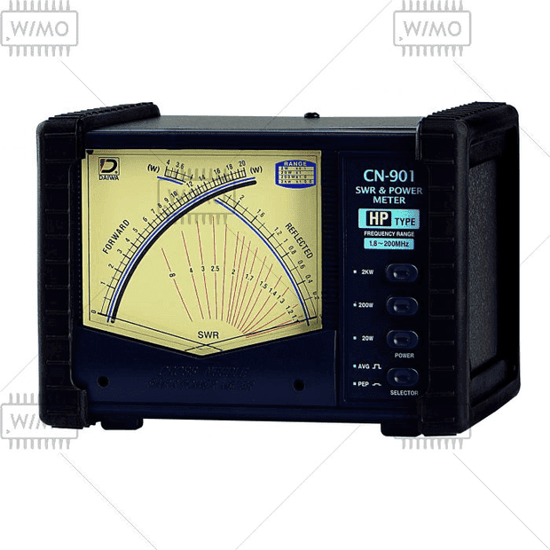

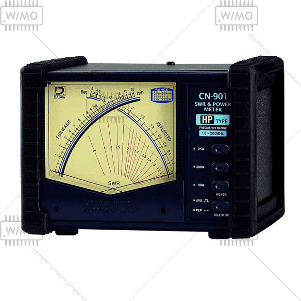

Can you just borrow an SWR meter instead? BTW, mV/m is the E-field strength.
https://www.wimo.com/en/cn-901hp-swr-meter
