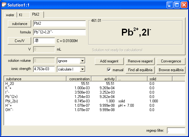

It is an online assignment and it says it is wrong. I have tried it two different times now and got the answer of .0012432355 both times and it is wrong.
Concentration of lead = .0012432355
Concentration of iodide = .003508607
ionic strength = .00474
activity of lead = .74557681557
activity of iodide = .92706917508
Have you checked if the results are self consistent?
Ksp = 0.0012432*0.74557*(0.0035086*0.92707)2 = 9.81*10-9
so this part looks OK, but
I = (4*.0012432+1*0.0035086)/2 = 0.0042407
is different from what you listed. Could be just a typo.
I did calculations using a specialized program and it shows very similar results (it uses slightly simplified method of calculation of activity coefficients, one that assumes radius of an ion over 305 is always 1, hence the differences).
(don't pay attention to the solid concentration, it is just a way of entering information about the solid presence). Activity coefficients are not shown in this view, but they were calculated to be 0.9270 and 0.7384.
Perhaps your result is correct, you are just fighting some significant figures issue?
