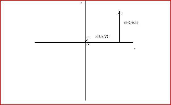

I haven't figure out any answer.
Let's see if I can proceed this procedurally.
On the assumption the motion is circular about the origin and counter-clockwise(Cartesian):
a(0π), velocity is in the +j direction.
a(π), velocity is in the +j direction
a(π/2), velocity is in the +i direction
OK - you think best in terms of axis:
put the initial velocity along the y axis.
Then ##\vec v(t=0) = v_0\hat\jmath## where v0=2.4m/s
If the acceleration were at 0deg, then ##\vec a = a\hat\jmath##
Where a=1.1m/s/s
- find the final speed after 3 seconds: ##|\vec v(t=3)|##.
is that bigger than, smaller than, or equal to the 5.7m/s given in the problem?

does this make sense?

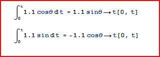

vx = [1.1m/s^2 cosΘ]3s
vy = [1.1m/s^2 sinΘ]3s
dvx/dt = 3.3ms^-1 d/dt cos Θ .dΘ/dt = -3.3ms^-1 sinΘ .ω
dvy/dt = 3.3ms^-1 d/dt cos Θ .dΘ/dt = 3.3ms^-1 cosΘ .ω

You're right I ought to have add the initial x-velocity to obtain the final x-velocity. Then determine the derivative (although as put it was irrelevant)
Let me work on your question.

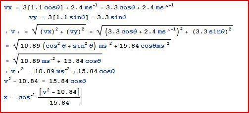

I'm starting to see the big picture of this question.
If the above is true, I suppose the next step would be to set the antiderivative of vx = 2.4ms^-1?
and if the arbitrary time, t, = 3. Then vx(3) - vx(0) = 2.4 ms^-1, am I right?
The above is not done correctly. Sorry. θ is not a function of t, so sinθ and cosθ factor out of the integral.
If you integrate those equations, it goes like this:
[tex]v_x(3)-v_x(0)=\int_0^3{1.1\cosθdt}=1.1\cosθ\int_0^3{dt}=3.3\cosθ[/tex]
or
[tex]v_x(3)=2.4+3.3\cosθ[/tex]
Similarly,
[tex]v_y(3)=3.3\sinθ[/tex]

I'm attempting the method where I square vx and vy. I'll finish that first and once I get the answer, I'll do it via integral.
I get an intuition the angle is zero but we shall see.
