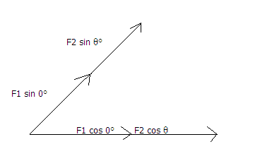

Find the angle between two forces of equal magnitude when the magnitude of their resultant is also equal to the magnitude of either of the forces
2. The attempt at a solution
x-component of the resultant:
Rx = F1 cos 0\circ + F2 cos θ
Rx = F1 + F2 cos θ
It's an Example in my book and I want to know why F1 cos 0\circ has an angle of 0. Also, I don't how they have done it either.

I've drawn the following diagram to solve it. Am I doing it right? Also, 0° is for the parallel vectors ?

Your diagram is a bit wrong i think.
First of all, if you set F1 on the x axis, then
F_1 sin 0 = 0
So F1 sin 0 should not be on the diagram. It is just zero.
Also...
F_2 sin \theta
is a y-component... however you have drawn it at an angle. It should be drawn vertically upwards. If you make these corrections, and then add the vectors again, you will arrive at the correct answer.
