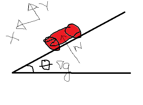

thanks for the replies. No, the car is not accelerating in the vertical direction, so i can see why the forces in the vertical must equal zero. I have been looking at a link at the bottom of the page to a question posted on here over a year ago which was asking the same question i am.
The first equation comes from centripetal force which you already figured out.
The second equation is the equation to keep The Car from moving in the air.
So, consider a box on floor => for that you would do N = mg
In this case. N = mgcostheta. because you don't want car to fly from the banked surface.
Just look at diagram(red thing is car(best i could draw in paint))
but
first eqn. is eqn for x-comp.
second eqn is eqn for y-comp
Also note: Normal is always perpendicular to surface and Force due to Gravity is always downwards

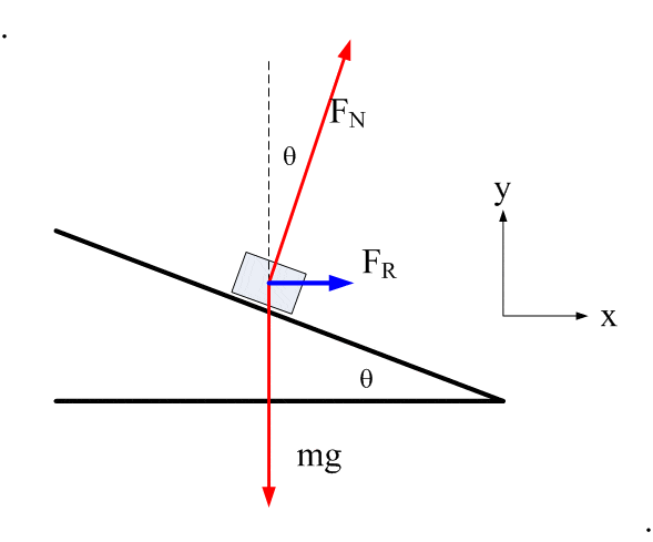

Sorry utkarsh1, but you haven't got your FBD quite right. The normal force is definitely not mgcosθ. That would only be true if there was no other acceleration happening that has a component parallel to the normal force. In this problem, the car is accelerating such that the acceleration is not perpendicular to the normal force. So mgcosθ, by itself, is not the normal force for this problem.
Lachlan1, Try this FBD (if your textbook doesn't already have its own FBD).
