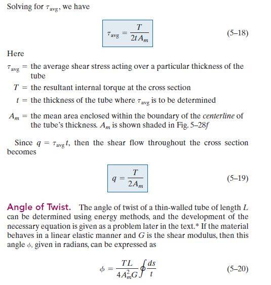

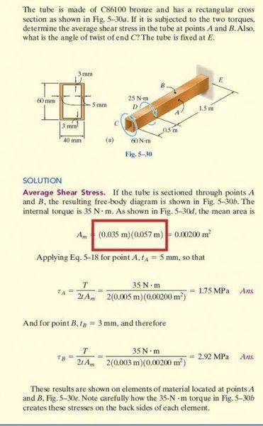

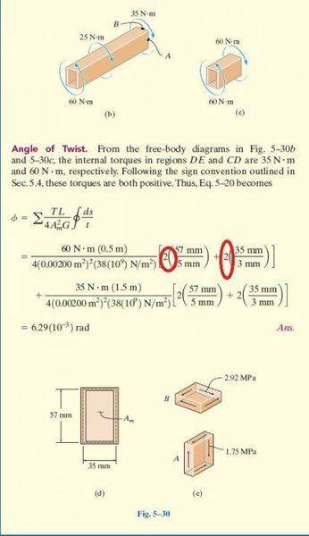

why the mean area enclosed within the boundary of the centerline of tube thickness is (0.035)(0.057) ? Is it wrong ?
Second question , why for the ds it's 2(57) and 2(35) respctively ? what is ds actually ?
for the first question , Shouldnt it be (0.040-0.005-0.005) x ( 0.060 -0.003 -0.0030 = 0.054 ?[/B]
No, it's right. Mean height is 54+3/2+3/2 and mean width is 30+5/2+5/2.
He's following the circumference of the mean area: the dashed line in figure 5-30 (d)
That's not an attempt, that's a question !
Anyway, that would be following the inside of the tube, which is not the intention here.

ok , i understand why it's 57mm and 35 mm , because it's the mean area enclosed within the boundary of the centerline of the tube thicknesswhy the thickness shouldn't be 3/2 and 5/2 mm now ? Because for the area of 57x 35 mm , the thickness of the 'frame' has been halved , right ?
I think the book is perfectly clear. He's following
which has a certain length and encloses a certain area. The tube thickness itself is of course not halved. (however, the expressions developed -- such as for 5-20 -- are valid only for thin walls)
why The tube thickness itself is not halved ? We can see that the figure in 7.30d , the thickness has been halved , right ?
for the original frame , we have the inner length of 60-3-3 = 54m and 40-5-5 = 30m , for the mean area it's 54+(3/2) + (3/2) = 57 , and 30+(5/2)+(5/2) = 35 , so the thickness for the mean area is 3/2 and 5/2 respectively , right ? Which the thickness has been halved ?

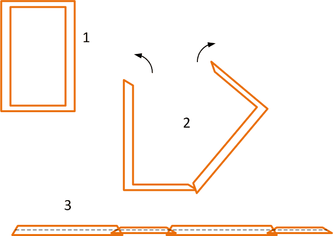

The dashed line is simply an average circumference. If you cut the pipe lengthwise you get a long sheet with a certain width and a certain thickness (that varies with lateral position, so it's kept inside the ##\int ds##). No halving.

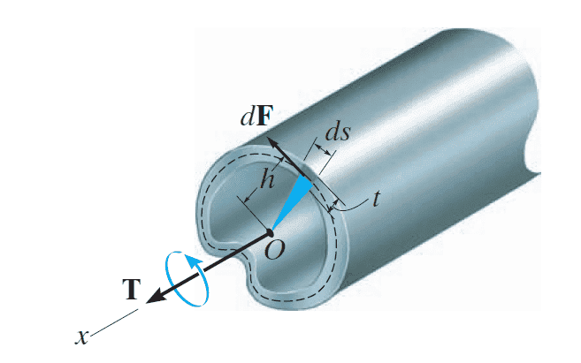

CIRCUMFERENCE ? I didnt see any circle here

why the thickness shouldn't be the same through out the length of the pipe ?
If you cut it lengthwise and fold it flat, thickness is the same throughout the length of the pipe. That's in the problem statement. You get a long slab of approximately 174 mm wide with two sections of 3 mm thickness and two of 5 mm thickness.

Do you mean cut the beam at 2 locations( cut off a portion of the beam) and hold it flat ?
How to fold it flat ? I couldn't imagine it at all
You don't have to actually do it ! :smile:

it's not the thickness of the wall bounded by the centerline ? it's still the same thickness before the centerline is drawn ?
Yes to the latter. The shear stress is distributed over the entire thickness (5-18).
I drew the centerline so you could see where the 174 came from; not to confuse you.

BvU said:
174 came from
174 ? where is it ?
With the browser find function CTRL-F you can see that it is in post #11.
My estimate was/is that you could have figured that out for yourself
It is the length of the dashed line in figure 5-30 (d), the same line.
And the correct number should be 184, not 174 o:) :biggrin:

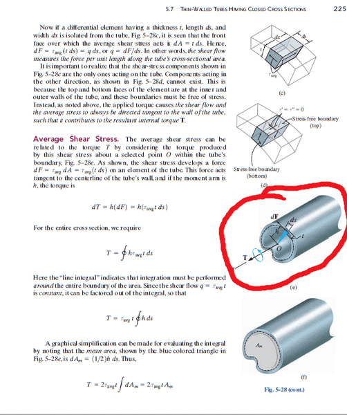

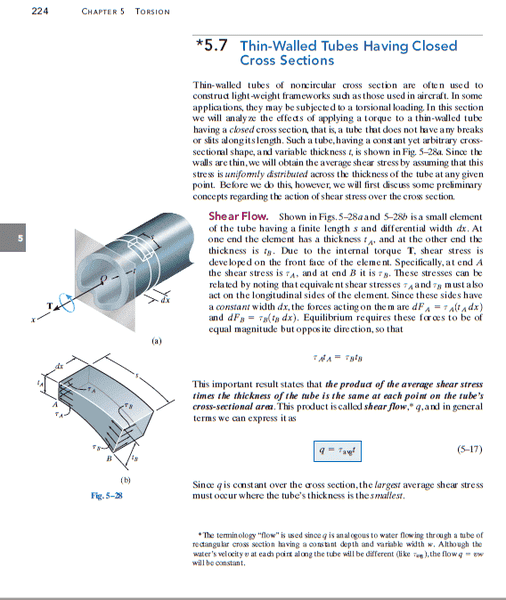

here's what i found for the t , from the figure , we can notice that it's not the thickness of the frame as you stated , rather , it's a width from the centerline to the outer surface
P/s : Here's the 3 consecutive pages of the notes .
