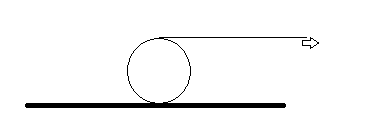

Yes I do have an example!
We have a cylindrical disc which lies on its side with a cord wrapped around it. You pull the cord with F tangentially forward (no angle for F that is relative the cylinder). Find the angular acceleration of the disc.
m = 100kg
static friction = kinetic friction = 0.2 (prob won't be)
F = 500N
R = 0.3m
I(c) = 1/2*m*R^2 (Given in question)
M = alpha*I(c)
M = F x R = FR
alpha = FR/I(c)
I(c) = (100*0.3^2)/2 = 4.5
alpha = 500*0.3/4.5 = 33.33 rad/s^2
This is when I'm using I(c) in the middle. Now instead if I'd use steiners and move to a parallel axis R meters from center i'd get
I(o) = I(c) +mR^2 = 3/2 mR^2
I(o) = 3/2(100*0.3^2) = 13.5, also I am moving down 1 R from F so M = 2RF
alpha = 2*500*0.3/13.5 = 22.22 rad/s^2
The difference is huge not only in answer but also understanding.

The problem here is that you have failed to consider all the forces. You forgot about the friction at the surface.
That's not an issue with the second method, since for that case the torque due to friction will be zero.

Yes, that is true!
I tried calculating it using M = F*R + 0.2*m*g*R as I assume friction is what it does, it hinders the attempted spin of the plate and creating a force helping my initial pull force. Though using this fact I get a much much higher angular acceleration of 46.42 rad/s^2. Even tried using friction as a negative force but that only got me 20.22 rad/s^2. Can you see where my calculations are wrong?
Two problems:
(1) You assume that the friction is μmg, which is incorrect. That's the maximum possible value of the static friction force--the actual friction force needed to prevent slipping may be less. Use Newton's laws to calculate the needed friction.
(2) What direction is the friction acting? As always, draw yourself a free body diagram.

Wow, you are so correct!
I've just re-calculated everything and this time used my brain and, low and behold, I got alpha in the exact form I wanted. This without using nifty tricks, just accounting for all forces in all directions.
I learned a great deal about friction and how to approach and think when we have objects of mass with a momentum.
