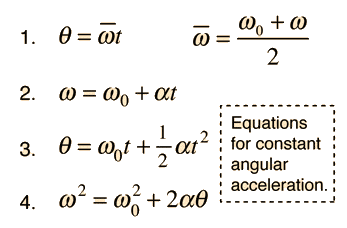

A cyclist starts from rest and pedals so that the wheels make 8.5 revolutions in the first 4.6 s. What is the angular acceleration of the wheels (assumed constant)?
I multiplied 8.5 by 2pi and then divided by 4.6 sec. I get an answer of 11.6 rad/sec, but they want an answer in rad/sec^2. Am I doing this right?

Not quite. What is the definition of angular acceleration?

The definition of angular acceleration is angular velocity over time. So, to get angular velocity from 8.5 rev/4.6 sec you have to find the angular velocity first. So, the definition of angular velocity (omega) is angular displacement over time, and the angular displacement is in radians. That is why I multiplied 8.5 by 2pi. Do I have to divide by 4.6 again?
I looked at that website and this is what makes sense to me:
8.5 rev * 2pi = 53.41 radians
53.41 rad / 4.6 sec = 11.61 rad/sec (omega)
11.61 rad/sec / sec = 2.5 rad/sec^2
2.5 is the wrong answer when I entered it. I am out of ideas.

Okay, how about this section of the website;
Which equation do you suppose would be appropriate in this case?

I think the right equation is w^2= wi^2+2a(theta)
but i used that assuming the initial angular velocity is 0 and its wrong
