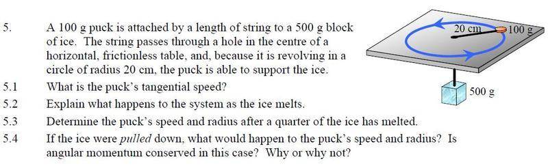

A 100 g puck is attached by a length of string to a 500 g block of ice. The string passes through a hole in the centre of a horizontal, frictionless table, and, because it is revolving in a circle of radius 20 cm, the puck is able to support the ice. (Refer to attachment for pic)
None.
I didnt understand this scenario as the whole question was weird. I don't understand how a puck can spin, without being dragged through the centre by the ice cube, since it weighs more and will thus pull puck down. How can this be a momentum problem even if nothing is colliding?
  • Diagram of a 100 g puck sliding in a circle on a horizontal table, tied by string through a central hole to a hanging 500 g ice block, with a 20 cm radius marked; the problem text lists parts 5.1 to 5.4.
Think of whirling a ball around on the end of a string. The string will be under tension - this is the centripetal force that keeps the ball moving in a circle. The same thing is happening here - the string is under tension, and that force on the puck keeps it moving in a circle. That same tension is transmitted to the ice cube and holds it up against the force of gravity. Given that, what do you know about angular momentum that will tell you how the system evolves in time?
Im not sure, all I know is that the momentum is mass x velocity and angular momentum is mass x velocity x r. I thought momentum had to do with objects colliding.
