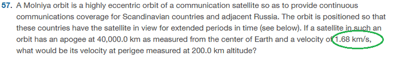

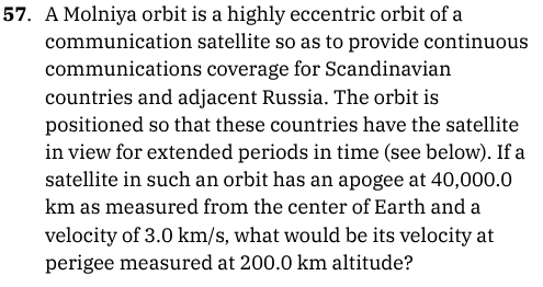

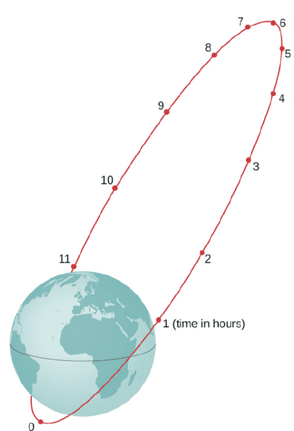

A Molniya orbit is a highly eccentric orbit of a communication satellite so as to provide continuous communications coverage. The orbit is positioned so that these countries have the satellite in view for extended periods in time (see below). If a satellite in such an orbit has an apogee at 40,000.0 km as measured from the center of Earth and a velocity of 3.0 km/s, what would be its velocity at perigee measured at 200.0 km altitude?
##L_i = L_f##
I'm trying to understand if I'm making a mistake because the answer in the textbook is ##10.2~km/s##.

I_Try_Math said:
After double checking, the answer I'm seeing in the book is 10.2 km/s. This is problem #57.
https://openstax.org/books/university-physics-volume-1/pages/chapter-11
Check the answer in the link that you provided.
Edit: Wow, that's interesting. When I clicked on your link a few minutes ago, I think I saw the answer as 18.3 km/s. Now it's showing 10.2 km/s. I guess I need to get my eyes checked! Anyway, your answer of 18.3 km/s looks good.
Here's what the link now gives for the problem statement:
Ok thank you for pointing that out. They must have an updated version of the text online now.
Yes.
The pdf version that you can download from OpenStax shows the problem as
Answer:
