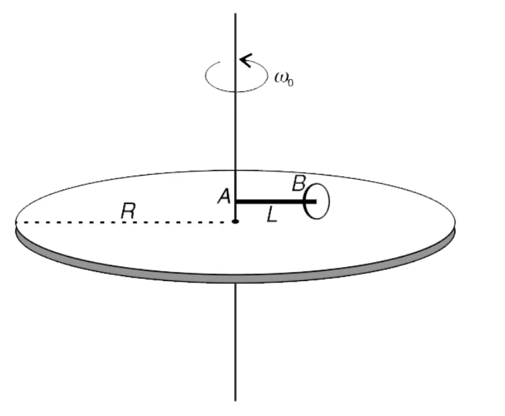

A uniform disc of mass M and radius R is rotating freely about its central vertical axis with angular speed w0. Another disc of mass m and radius r is free to rotate about a horizontal rod AB. Length of the rod AB is 𝐿 ( < 𝑅 ) and its end A is rigidly attached to the vertical axis of the first disc. The disc of mass m, initially at rest, is placed gently on the disc of mass M as shown in figure. Find the time after which the slipping between the two discs will cease. Assume that normal reaction between the two discs is equal to mg. Coefficient of friction between the two discs is μ.
Tau= Ialpha , L=Iw
Consider the diagram shown above.
I came up with two ideas to solve this: i) I do not see any external torques about the vertical axis in this problem. so, angular momentum is conserved about this axis. (is it?)
ii)the standard way, that is, writing newton's second law for rotation, and applying the condition for slipping to cease, i.e the velocity of the contact point is zero.
let me show my working for the (ii)nd idea first:
assume after time t slipping ceases and pure rolling starts, and at that time angular velocity of horizontal disc is ω and the angular velocity of vertical disc is ω ′.
\begin{align}
(1)\quad & r\omega' = L\omega \\[6pt]
(2)\quad & \omega = \omega_0 - \frac{\mu m g L}{\tfrac{1}{2} M R^2}\, t \\[6pt]
(3)\quad & \omega' = \frac{L\omega}{r} = 0 + \frac{\mu m g r}{\tfrac{1}{2} m r^2}\, t \\[12pt]
& \text{From (2) and (3):} \\[6pt]
& \frac{L}{r}\left( \omega_0 - \frac{2 \mu m g L}{M R^2}\, t \right)
= 2\frac{\mu m g r^2}{m r^2}\, t \\[12pt]
\implies\quad
& t = \frac{M R^2 L \omega_0}{2 \mu g \left(M R^2 + m L^2\right)}
\end{align}
as expected, this yields the correct answer. however, the first method has some confusion.
first off, IF at all angular momentum is conserved, there will be a component of it which is NOT in the z direction(that is ## L_{about cm}##), for the smaller vertical disc.(using the fact that ##
L = L_{\text{cm}} + L_{\text{about cm}}##)
but if we ignore this and conserve angular momentum only about the z axis, I get the answer
##\begin{align}
t = \frac{M R^2 L \omega_0}{2 \mu g \left(M R^2 + 2m L^2\right)}
\end{align}##
which is incorrect for some reason.
Please help.
I do not think that the angular momentum of the whole system about the vertical axis is conserved because of this:
palaphys said:
rigidly attached

We can take it that the vertical axle is constrained to be vertical, so we cannot assume there is no horizontal external torque on it.
As @wrobel points out, we are told the horizontal axle is attached rigidly to the vertical axle. It is not entirely clear, but there seems no purpose in that information unless we are also to infer that the vertical axle cannot rotate on its own axis. Thus, we cannot exclude an external vertical torque on it either.

As with linear momentum, it can be conserved in one direction but not in another. With only gravity acting, horizontal linear momentum is conserved but not vertical linear momentum.
But as I thought I explained, in this question you cannot assume angular momentum is conserved in any particular direction. To keep the vertical axle from rotating about its own axis there must be an external vertical torque, and to keep it from rotating about a horizontal axis there must be an external horizontal torque.

If the rod AB can rotate freely about the vertical axis then the projection of the angular momentum of the whole system on the vertical axis is conserved.
Another task is calculate this projection correctly

The original statement of the problem is that the rod AB can not rotate so there must be a torque that keeps it at rest. I don't see any ambiguities in the original statement.
The ambiguity is in the interpretation of "rigidly attached". It could mean
  1. That the "rigid" connection is through a bearing so that the rod can rotate freely at A about the axis
  2. That the "rigid" connection is made by gluing the rod with superglue to the axis at point A in which case the rod rotates as a "rigid body" with the axis.

I see the wording issue a little differently.
In usual terminology , an "axis" is not a physical object, any more than is a line or plane; you cannot attach something to it rigidly. So presumably they mean "axle". But there are two ways of mounting a disc on an axle. The disc might be able to rotate around the axle or, perhaps more commonly, the axle might rotate within its supports and be rigidly attached to the disc.
For the question to work as intended we needed the "disc spins on axle" arrangement.

Let me get this straight.
We start with the rod at rest. Point A of the (massless) rod is welded onto the (massless) axle. At point B a small disc of mass ##m## and radius ##r## is free to rotate about the rod.
The rod-disc assembly is held above the platform which has mass ##M##, radius ##R## and is rotating freely about the axle with angular speed ##\omega_0##.
At some point in time the axle with the rod-disc assembly is gently lowered onto the rotating platform so that the disc comes in contact with it. Since the assembly has, by assumption, the mass of the disc ##m##, the normal force between the surface of the platform and the disc is ##mg##.
OK, that makes sense. Thanks.
