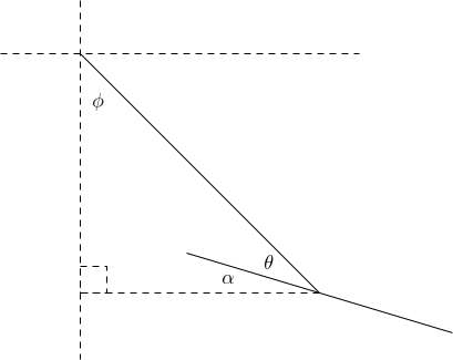

Find the angular momentum of the system of two particles in the figure connected by a (massless) rigid bar.
$$L=r_{left}\times mv_{left}+r_{right}\times mv_{right}$$
Lets do it for the left (the right will be similar): ##r_{left}=[(L-a\sin\theta)\sin\phi,(L+a\cos\theta)\cos\phi]## so ##v_{left}=[-a\dot{\theta}\cos\theta\sin\phi+(L-a\sin\theta)\dot{\phi}\cos\phi,-a\dot{\theta}\sin\theta\cos\phi-(L+a\cos\theta)\dot{\phi}\sin\phi]##. Is this right?

You have omitted a from your expressions, and anyway your expressions for the r coordinates are wrong. Draw a diagram showing where ##(L-a\sin(\theta))\sin(\phi)## is.
But I think it will be much easier treating both particles together and using the parallel axis theorem.

Try ##\theta = 0## in your equation for ##r_{left}##. Something is not right there.
Also, no, the expressions are not correct. You cannot have factors such as ##L-\cos\theta## as the physical dimensions of the terms are different.
It should then be ##r_{left}=[(L-a\cos\theta)\sin\phi,(L-a\cos\theta)\cos\phi]##? That will not work when ##\theta=\pi/2##
Wild guesses won't get you there.
Draw a horizontal line through the top pivot (O) and vertical lines up to that from the left mass and the lower pivot, meeting it at A, B. Can you figure out the lengths of OB, AB?

The length of ##OB=L\sin\phi##. The length of AB requires some trigonometry involving ##\theta## which is not obvious to me.
Can you figure out the angle ##\alpha## in this diagram in terms of ##\phi## and ##\theta##?
##\phi+\theta+\alpha=\pi/2## that would mean that ##\alpha=\pi/2-\phi-\theta## and hence ##AB=a\cos\alpha=a\sin(\phi+\theta)##?
Yes
