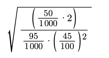

This is the math I did when I rearranged
to solve for w, angular velocity. I used I = mr^2. I got w = 2.27995. The units would be the sqrt of(J /kg*m^2), which ends up just being 1/sec. to get the answer in rpm, I figured I would multiply w by 60sec (to get w = 136.797, but this wasn't right
Please use LaTeX to write your equations in symbolic form. It is not at all clear what the numbers you posted in #3 are all about. Also, what is the moment of inertia of the rod? Look it up.
aivilo775 said:
I used I = mr^2
It's a uniform rod, not a point mass.
