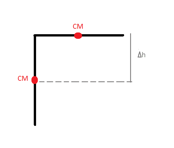

When solving a problem, I had to calculate the angular velocity of a homogenius rod when it comes to vertical position, after being released from a horisontal position (the rod is fixed at one end). This is as usually done with energy conservation, using the rotational energy of the rod and setting it equal to the change in gravitational potential energy. If the length of the rod is L and its mass m, the following is obtained (Δh=L/2):
mL2/3 *ω2/2 = mgL/2
--> ω = (3g/L)^(1/2)
However, I started wondering if this problem could be solved using translational kinetic energy instead. If we consider the center of mass (CM):
mv2/2 = mgL/2
--> v = (Lg)^(1/2)
--> ω = v/(L/2) = 2 (g/L)^(1/2)
As seen, this does not yield the same answer as if we use rotational kinetic energy.
My question is: Why can't translational kinetic energy be used to calculate the angular velocity? or if it can be used: Where am I thinking wrong?

You can use translational energy but would still have to include the rotational energy about the center of mass.
Consider a 2 sticks sliding across ice.
If one was rotating and the other was not rotating then there would have to be a difference in their total energies.

The rotational energy of a rod (or any rigid body) is the sum of the translational energies of its tiny pieces.

You can think of the motion of the rod at some instant as the sum of a linear motion of its mass centre plus a rotation about that mass centre. Each contributes to the total KE. Your translational energy assessment lost the rotational energy.
Another way to think about it is to consider ehild's point that the total KE is the sum of all the little KEs. If the KE of a small piece of the rod were proportional to its distance from the axis then reducing it to the motion of the mass centre would work. But its the velocity of a piece that's proportional to the distance from the axis, and as we know, the KE rises as the square of the velocity. So the parts further from the axis carry disproportionately more KE. That puts the effective mass centre (for this purpose) further from the axis, so with a higher velocity than the mass centre.

Thank you very much Sir! This explained a lot!
So, does this also mean that I could use kinetic energy if I integrate v along the rod?
If you integrate v2 along the rod, yes.

So if ## dm = A \rho dr## where A is the cross-sectional area of the rod:
## \int_{0}^{L} A \rho g r dr = \int_{0}^{L} \frac{A \rho v^2 dr}{2} ##
## \frac{gL^2}{2} = \frac{1}{2} \int_{0}^{L} v^2 dr ##
Now, ##v= r \cdot \omega## , thus:
## \frac{gL^2}{2} = \frac{\omega^2}{2} \int_{0}^{L} r^2 dr ##
which yields ## \omega = \sqrt\frac{3g}{L} ##
which is the same answer as obtained when using rotational energy.
