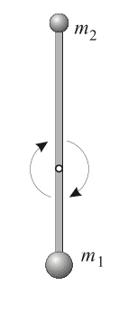

A rigid uniform rod of negligible mass is able to rotate around a pivot. Two masses, ##m_1=250g## and ##m_2=200g##, are placed at the ends at distances ##d_1=100cm## and ##d_2=150cm## from the axis of rotation. The system, originally stable in its vertical position, gets moved slightly in the clockwise direction, putting it into rotation. Friction is negligible.
##\rightarrow## what's the angular velocity of the system when it passes from its position of stable equilibrium?

Hi guys,
I don't really know how to solve this problem.
The point is finding ##\omega## when ##m_2## passes from ##m_1##'s original position.
Ideally, I'm thinking about some conservation of energy/momentum to apply here, but I'm quite confused.
Any hint?
Begin by calculating where the center of mass is. Is it above or below the axis of rotation. That will give you a clue about (stable-unstable) equilibrium
Yes, you have three to choose from: energy, linear momentum and angular momentum. Which will be conserved for the rod and masses system in this situation?

It is not really a question about equilibrium, stable or otherwise. In fact the question is stated incorrectly. The initial position is one of unstable equilibrium.

Point out errors, correct misunderstandings, offer hints.
But my comment to you was not to do with forum rules. Rather, I felt your post might lead Greg in a wrong direction.

I respectfully disagree. Instead of saying him that the question is incorrectly stated I am trying to make himself to figure it out why the first use of word "stable" is not well suited there. And only way to figure it out this is to calculate the position of center of mass (which he is going to need to work towards the answer)
greg_rack said:
The point is finding ω when m2 passes from m1's original position.
Be careful! d1 is not equal to d2.
