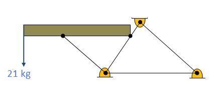

Hi guys,
Below is a picture of what I am given. I need to calculate the support reaction forces and the stress in each truss. Having problems resolving the offset weight.
All the supports are pin supports. Any ideas how to get started?
Can't even get started as i have too many variables compared with equations to initially find the Rx Ry support forces.
Anyone?
Is the noly way to do it is to remove one of the supports?

The picture is now approved.
It does not, however, show the elastic properties, E and A, nor the geometric dimensions required to do the calculations. I assume the horizontal beam is infinitely rigid.

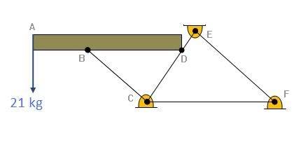

To be able to make discussions, I have named the joints A, B, C, D, E, F, starting from left to right, and where the load 21 Kg is applied at A.
Could you please supply the member properties (E and A) as well as details of the geometry?
From the diagram, it does not look like it is a linear problem, because the point D can have a transversal displacement, which has a non-linear relationship with the axial forces of CD and DE.
For the solution, you can proceed as follows:
Unknowns: 4 displacement, Bx, By, Dx, Dy
Equations:
Equilibrium of forces at points B and D
Axial force on member BC
Moments of forces and reactions.
If BD is supposed to be rigid, a large value of A and/or E must be applied to member BD.
Hope this will give you a kickstart.

Ok cool. yeah here is a bit more info.
AD is just to show that the force due to weight is not directly on B. It's not rigid or attatched to member BD (sorry it looks like it in the picture).
CF=1m
EF=1.5m
CE=1.4m
CB=1.6m
AD=3m
It's supposed to be a truss problem, just finding the reaction forces in supports and internal truss forces. Not sure about deflection.
E is 20GPa and A is 111mm2.
Looking for method of joints + method of sections?
I'm getting a trivial result with a matrix inverse unidentified solution of 6 equations and 6 unkowns. zzzz.
Is E on a horizontal slider? If it is, then the structure is unstable.
If it is not, the joint F and members CF and EF are not stressed, i.e. the given load has no effect on them.
Also, for the structure to be stable, the rigid beam AD is required. Otherwise point B will spin counter-clockwise around C.
If we disregard non-linear effects, and the members CF and EF, then you are left with the structure ABCDE where C and E are pinned.
If CDE is rigid, then the reactions at C and E are vertical.
You can calculate these vertical reactions by taking moments about E and C respectively.
