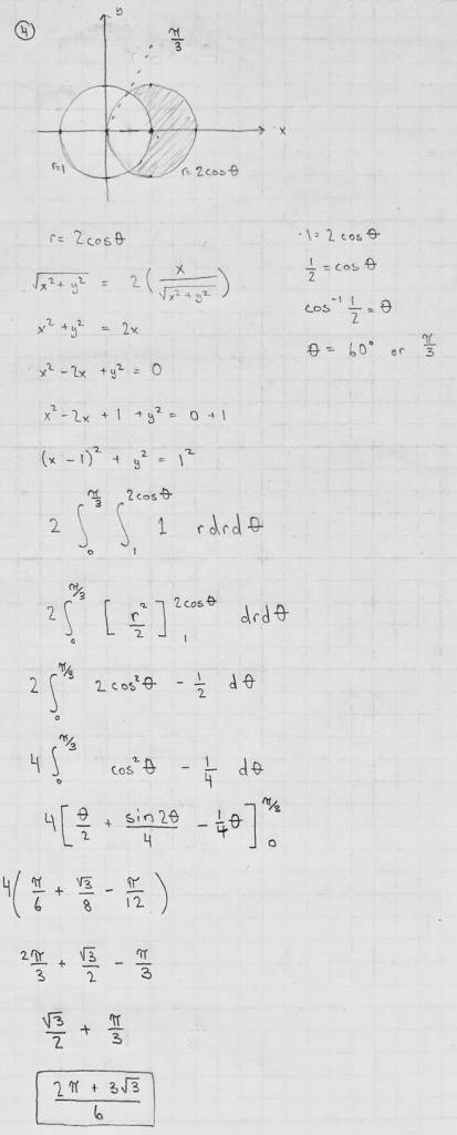

Here is the problem I am dealing with...
And this is how I approached it. Can anyone confirm that I did it correctly and got the right answer?
Thank you.
  • Typed problem 4: Use iterated double integral(s) to find the area inside the circle r = 2 cos θ and outside the circle r = 1
  • Handwritten polar double integral solution: sketch of circles r = 1 and r = 2cos(theta) with shaded region between them, then steps reducing to 4 times integral of cos^2 theta minus 1/4 from 0 to pi/3, ending with boxed result (2pi + 3 sqrt 3)/6.
Yes, it's all good. (Yes)
