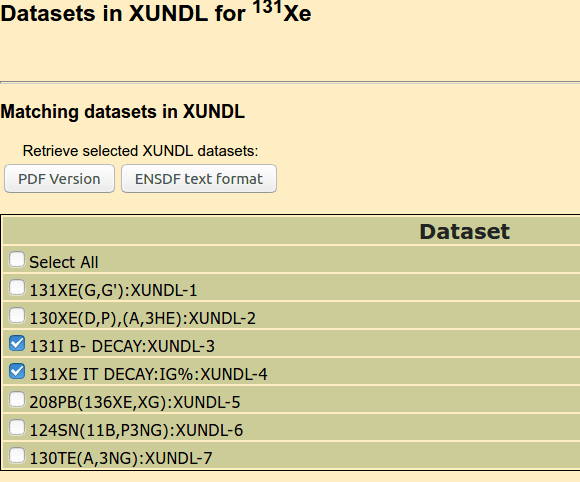

This is how XUNDL webpage looks like. In you example case, you might be interested in decay of 131I to 131Xe
Screenshot of the XUNDL web page titled Datasets in XUNDL for 131Xe, listing datasets with checkboxes; 131I B- DECAY:XUNDL-3 and 131XE IT DECAY:IG%:XUNDL-4 are checked.

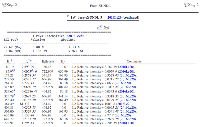

You may inspect the list of gammas associated with such decay and the level scheme. Here you can see the list of gammas. The 30 keV x-ray are the K-alpha and K-beta characteristic X-rays.
XUNDL table of gamma transitions for the 131I beta-minus decay to 131Xe, listing gamma energies, relative and absolute intensities, level energies and comments citing 2016Le20.

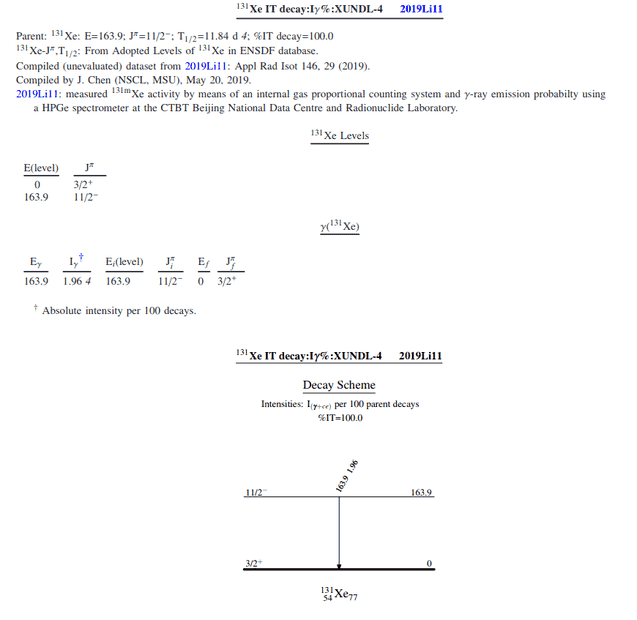

On the other hand, you have to look for the IT...
Decay scheme for 131Xe isomeric transition: a single 163.9 keV gamma transition with intensity 1.96 from the 11/2- level at 163.9 keV down to the 3/2+ ground state at 0, with the nuclide symbol 131 54 Xe 77 below.
The coincidence of IT electrons with characteristic x-rays is implicit.

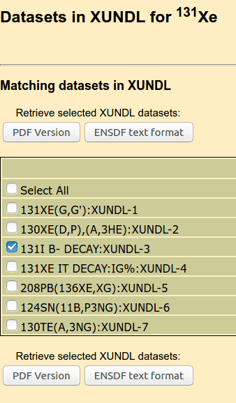

  • Screenshot of the XUNDL dataset selection page for Xe-131, listing matching datasets with checkboxes; the '131I B- DECAY:XUNDL-3' entry is checked, with PDF Version and ENSDF text format retrieval buttons.
