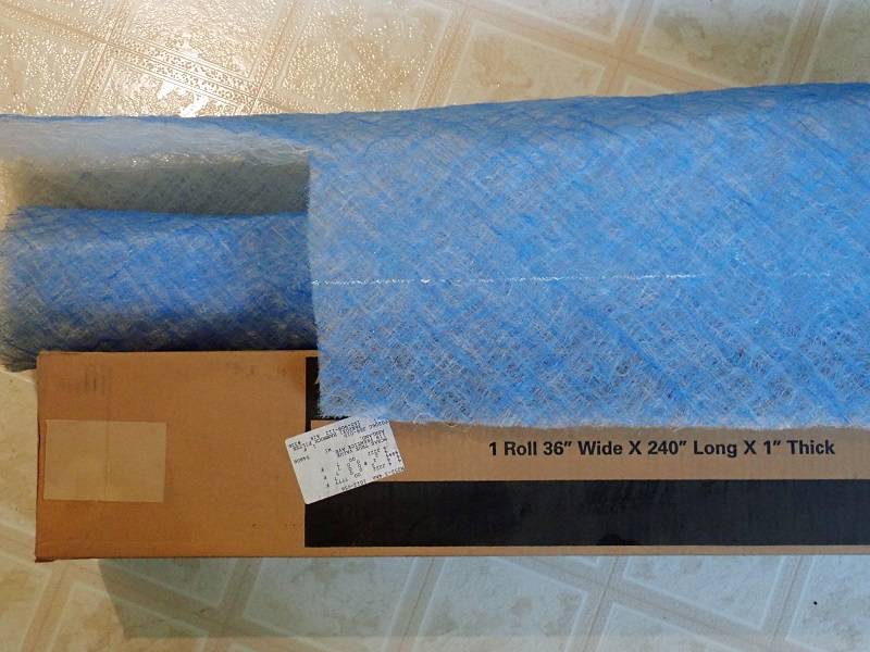

You can reduce the cost by adding an additional prefilter over the existing prefilter. Filter blanket material is available in most hardware stores, which is where I found this:
The pressure drop is very low, and it is cheap.
Great idea! But I am not sure that that looks like the advertised 1" thick. I would check that. ;-)

Would that 3rd filter layer reduce the suctioning ability of the fan in the purifier (i.e., like giving it too many barriers?
