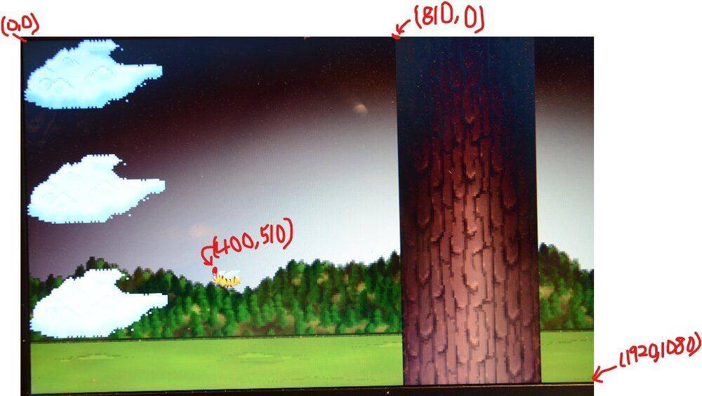

you can see I see the coordinates of the sprite of tree at (810,0) in line 18. and sprite of bee is (400, 510) in line 24. Why the sprites display so off on the screen? Got to have a very simple explanation why I am off that I missed.

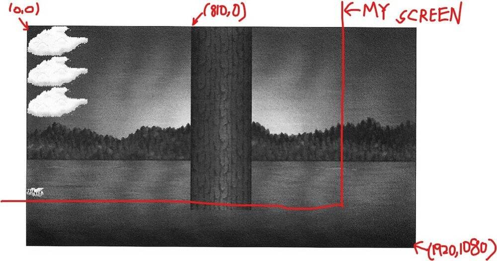

I found out what really is wrong. I still don't know how to fix it. This is the image from the book running the program ( I change the position of the bee, everything else is the same position). The book is cheap to only have black and white picture!
This looks correct. The problem is my screen ONLY display part of the picture as shown with the red outline. You can see the part below the tree is not shown in my program with my computer.
It must be some sort of setup problem that when the program is set to full screen, it ZOOM in too much and cut out the higher number of x and y. That's why my image is off. Must be the setting in line 7 in the program in post 1 is off.
Any suggestion?
thanksEDIT: I checked my laptop, it can only set to 1366 X 768 resolution. Maybe that's the problem.

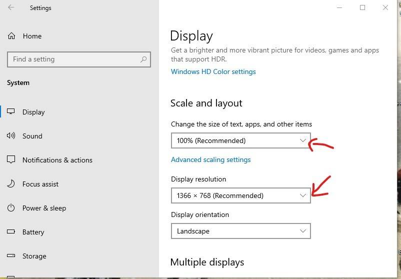

I have no idea how to fix this. I tried changing line 6 VideoMode vm(1920, 1080) to match, it did not work. I tried other numbers also, it doesn't seem to make any difference.
I tried going to computer->setting-> display and play with these, it didn't work either

Anything I can try?

I tried setting the program resolution to 1366 X 768 in line 6 of the program in post 1. That was the first thing I tried. It did not work. I think the image is programmed to be 1920X1080. So the image is bigger.

I am pretty sure it's my laptop. I put the bee in (683, 384) which is half way of (1366, 768). I have the stupid bee at DEAD CENTER!

It's in PNG (portable network graphics) format, so you can edit the image in, say, Paint, to change its size, to get the width and height down to 1366 pixels by 768 pixels.
I think I got the answer from SFML, I have to read about sf::view, view is a class in SFML and view has member function for setting center and all sort of stuffs. This is the link I am reading now. Maybe you guys might find interesting:
https://www.sfml-dev.org/documentation/2.5.1/classsf_1_1View.php

Yes, I did try that, I can just size the background easily, but I have to size down each of the sprite to fit in the picture. eg. if the tree is 200X600, I have to multiply the number by (1366/1920) to get 142 X 427 to scale down the size of the tree. Then I have to know the new coordinates in 1366 X 768 on the screen.
But I want to follow what suggested to me and read the class view of SFML first to see whether I can do it easier.
